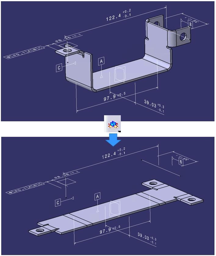

Hello CATIA community,
when I am using „Functional Tolerancing & Annotations“ with sheetmetal parts and I switch to unfolded view the dimensions are not changing.

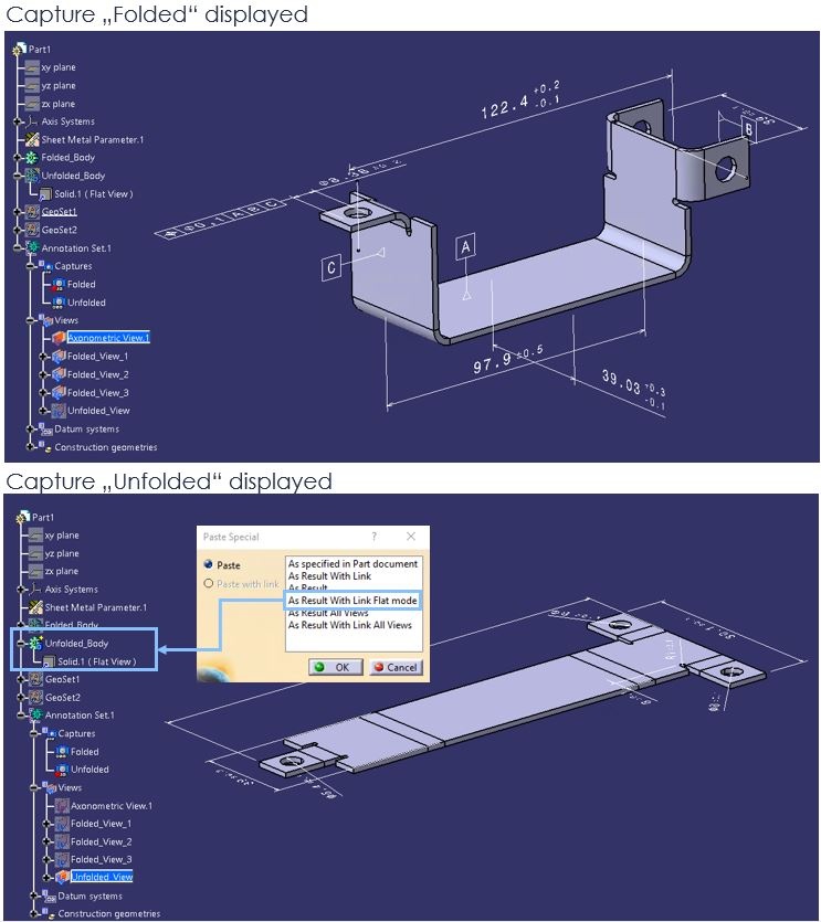

To use FTA also in the unfolded state I paste the original body „As Result With Link Flat mode“ in the same CATPart and I can visualize GD&T for the folded and unfolded view with different captures ​​​​​​​.
What do you think about this solution?
Is there an other way to do this?
