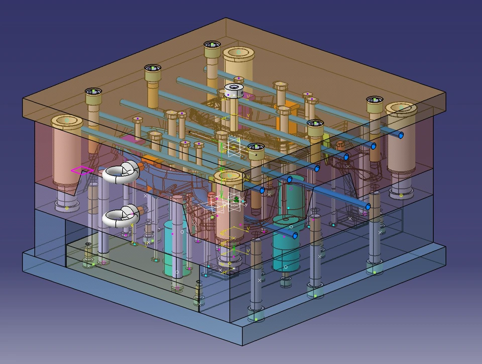

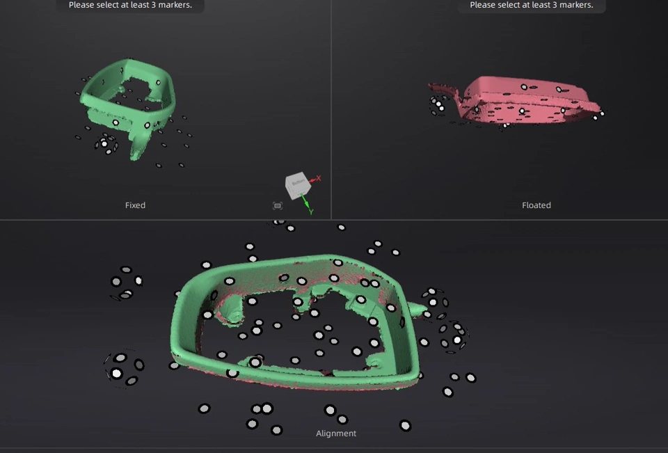

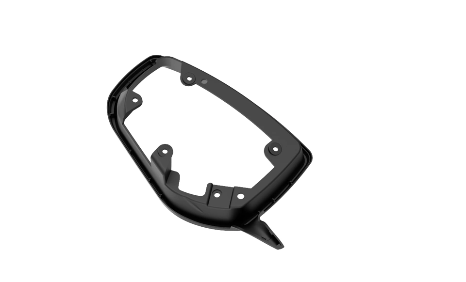

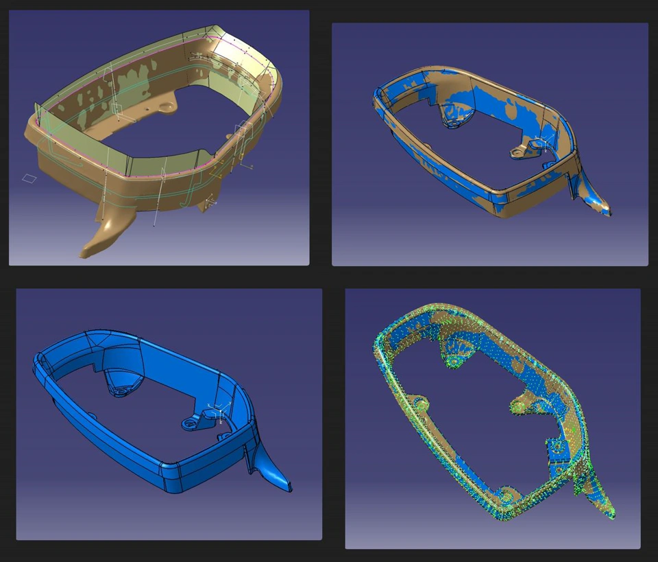

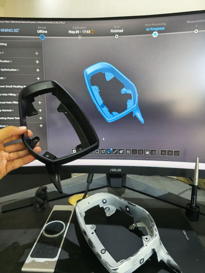

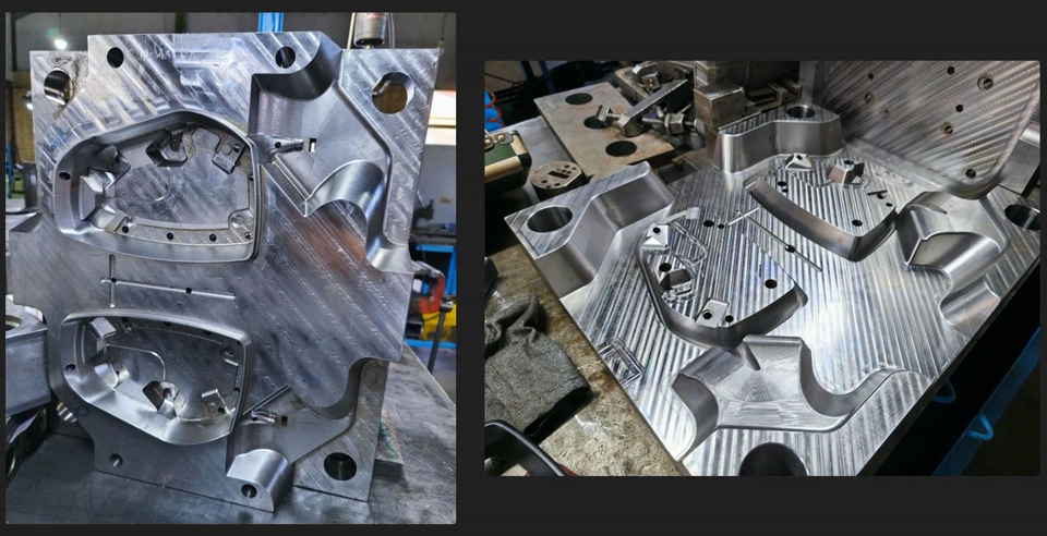

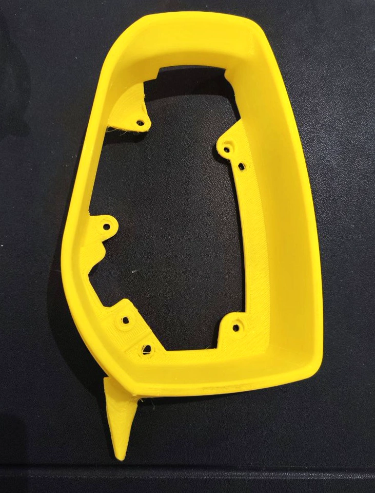

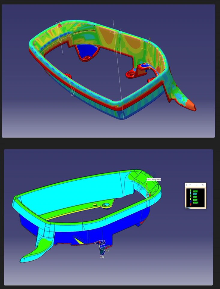

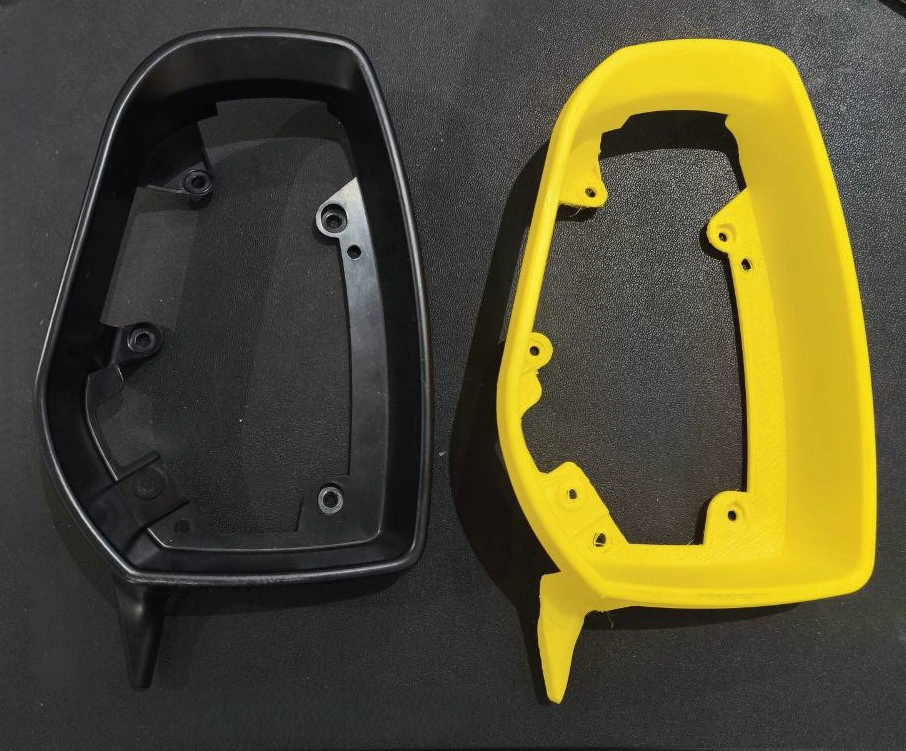

This project began with 3D scanning of the original part, followed by digital modeling and design optimization. After producing a 3D printed prototype for dimensional verification and customer approval, the injection mold was designed.

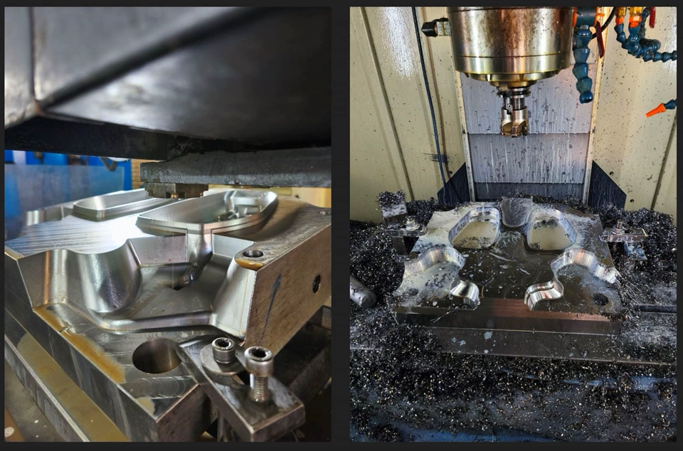

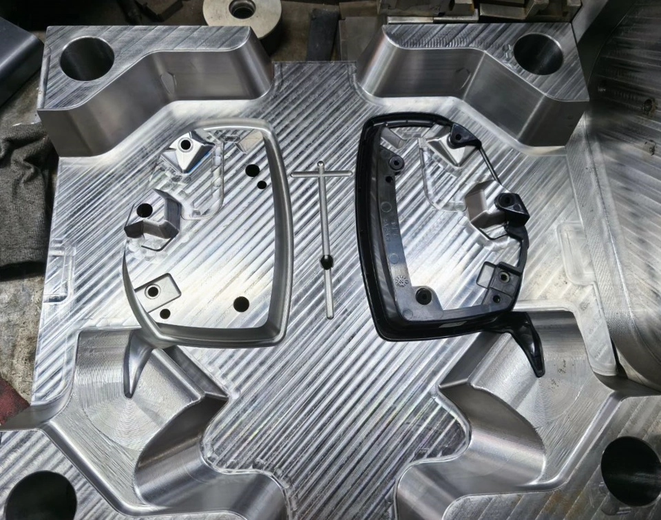

Currently, the mold is under manufacturing and in its final stages, being processed with CNC machining, EDM (spark), and wire-cut operations.

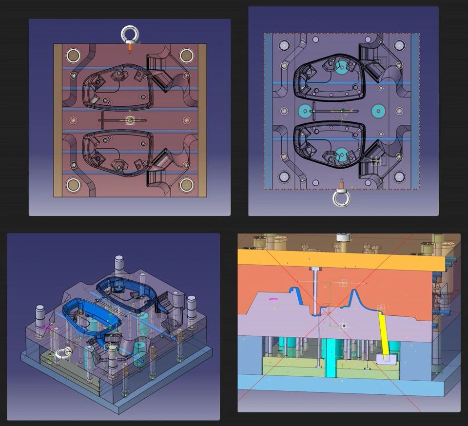

Mold & Part Specifications:
Cavities: 2 (left & right)
Runner type: Cold runner
Gate type: Pin gate
Ejection system: Ejector pins + lifter
Mold type: Two-plate mold
Part material: ASA
Part weight: 67 g
I have been responsible for the entire workflow — from scanning and modeling to mold design and now overseeing the final steps of manufacturing.
