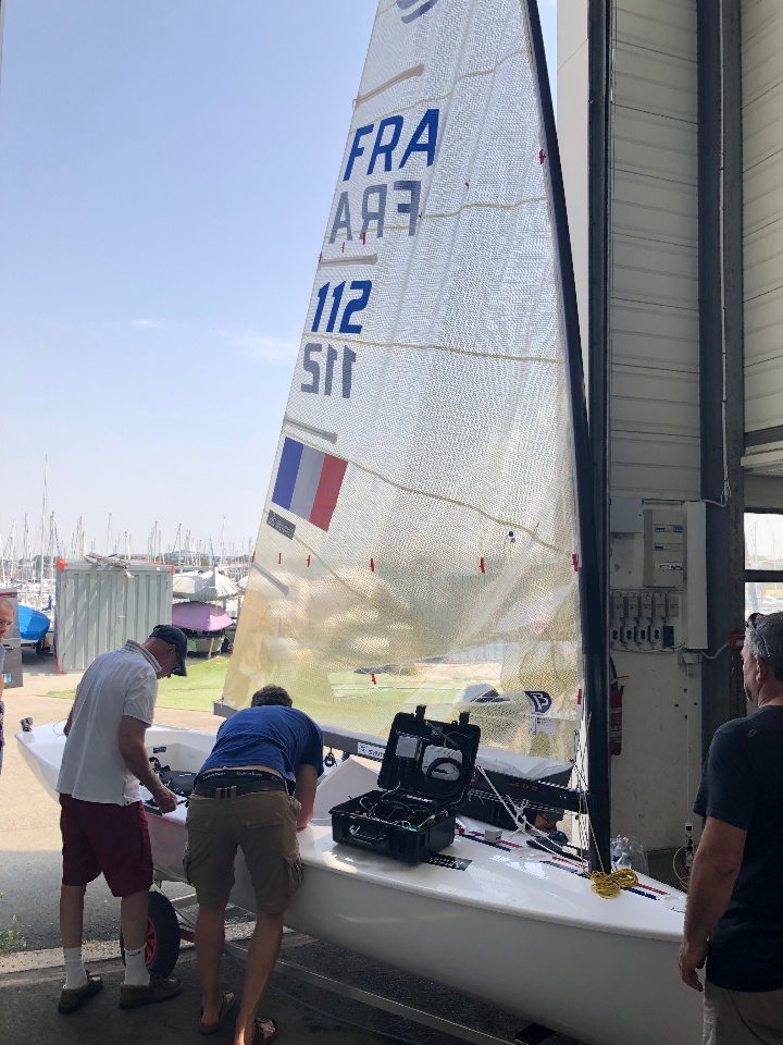

After the fifth episode about the manufacturing of the composite mast, and the global preparation to sail, we will introduce you the work we performed on-board with Jonathan Lobert to validate the accuracy of the manufactured mast regarding the virtual simulation using the 3DEXPERIENCE Platform.

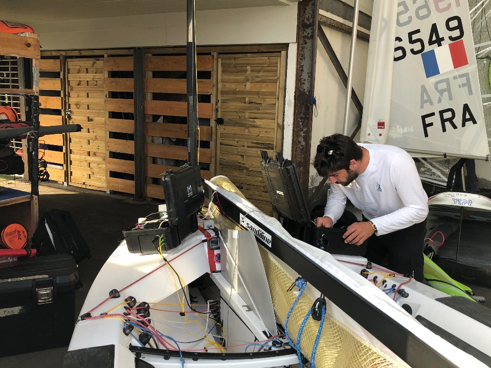

Optical fibre monitoring has been setup in partnership with Pixel-Sur-Mer to measure in-situ strains along the various sailing conditions. The monitored strains are expected to be used in three different ways:
- The reconstruction of mast deformation to ensure the deformation is matching the expected shape for the sail,
- The deformation can be observed along the time while sailing in various waves & wind conditions to get a better understanding of the most accurate way to tune the mast and estimate the effect of parameters (sheet tension, out-haul, Cunningham),
- The understanding of the dynamic of the mast to observe the difference regarding wind shifts & waves,

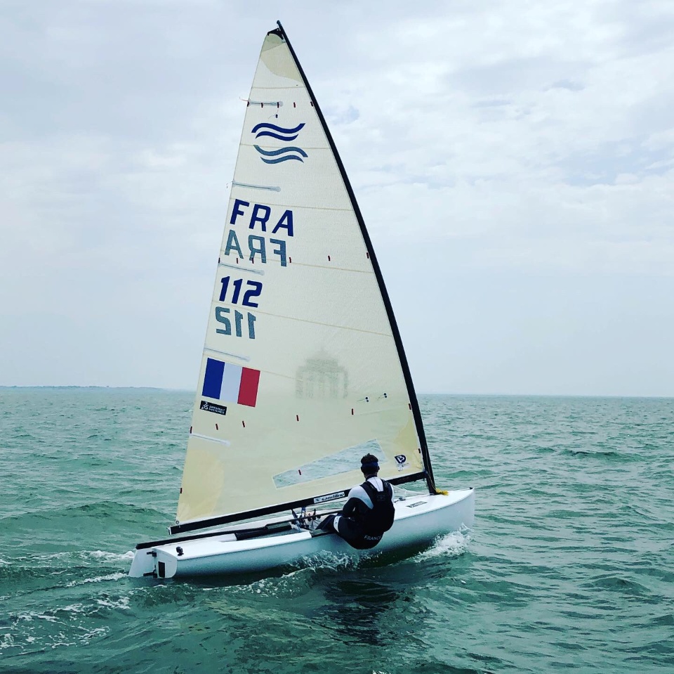

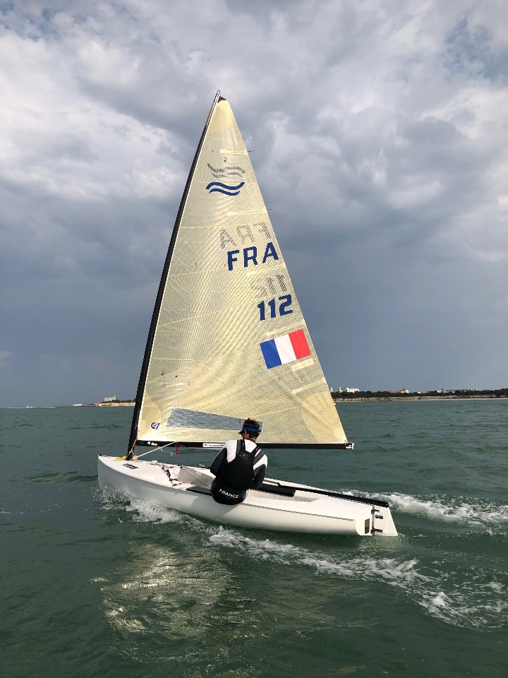

This testing campaign demonstrated the huge interest of the strain monitoring on-board and the reliability of the new mast tested. Road to Olympics continue with slight enhancements on the next mast. Next update at the Olympics next summer !
