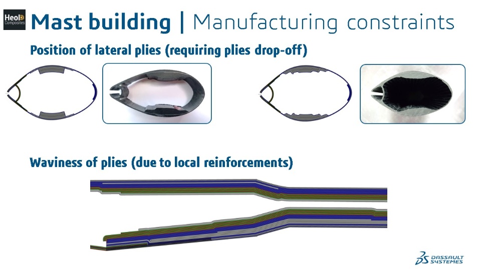

The ability to laminate the mast was virtually checked using Producibility capabilities. Moreover, the details of the lamination are reviewed with the manufacturer to ensure and estimate the possible sources of variations along the hand manufacturing of the almost 100 plies of the stacking sequence.
