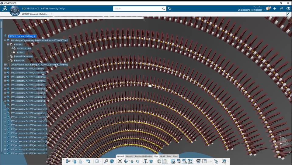

When you working with the parametric design and working with the details in large project, it often occurs the problem with heavy data management. Thanks to the assembly system that allow us working with light data. This full video example shows how to modeling in assembly level with Engineering Template and EKL that allow us bring parametric design intend.
Key Point

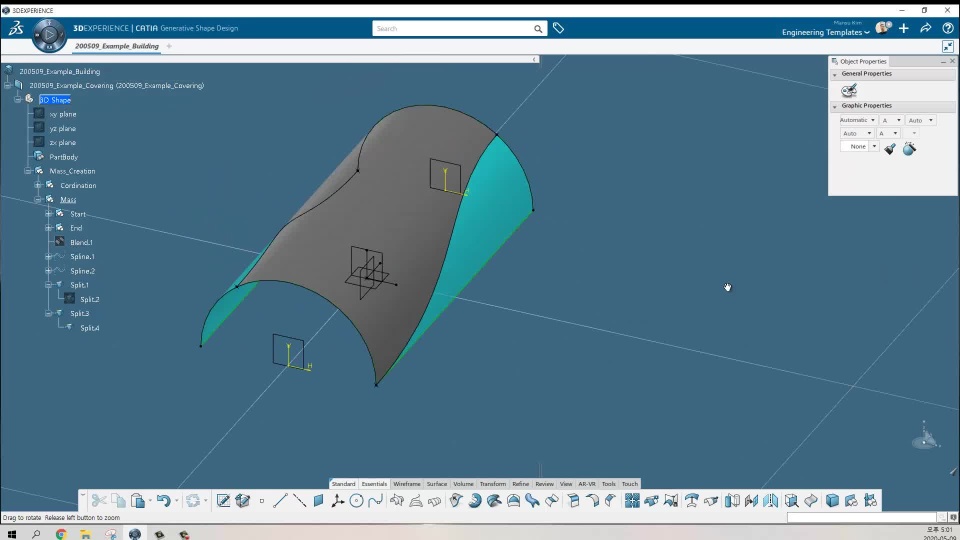

1)Test in Part level that your design and Automation works well with simple objects.

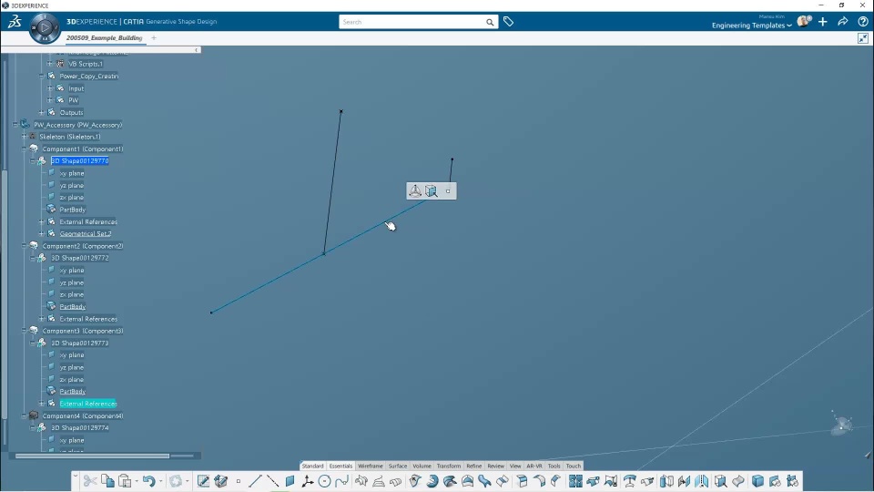

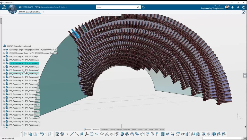

2)Build an Assembly that fully Detailed. you can build Drawing in same time if it's necessary

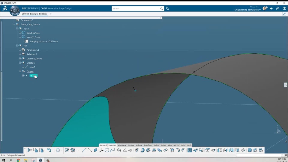

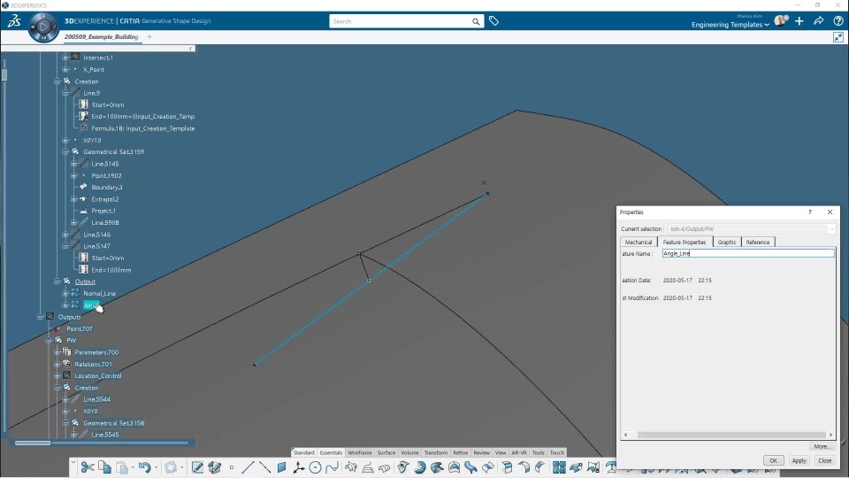

3)Create Engineering Template by Engineering Template, Resource Table, Action.
