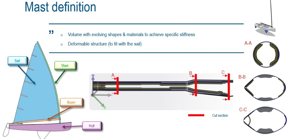

What is a mast?
A mast is an aero shape resulting from fluid simulation to reduce the drag of the profile. A changing composite layup is used along the height of the mast in order to achieve a target stiffness matched to the sail geometry in various wind conditions (from 5 to 25 knots) and various sailing direction (upwind to downwind).

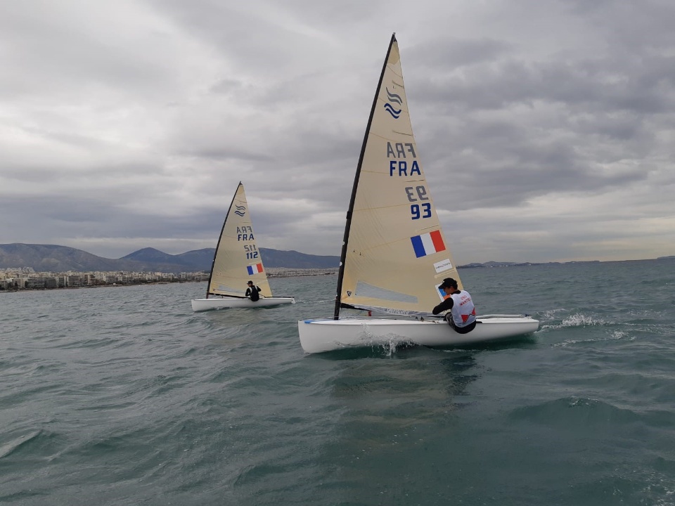

Our challenge is to find the optimal shape and the associated composite layup to improve the behavior of the mast in a short period of time to the road of Olympic Games. Jonathan is then using the masts to validate (or invalidate) the improvements we can see on the computers.
Jonathan is an efficient sensor who provides us tinny variations of behaviour of the mast. But Jonathan is not providing us mm, forces … but feelings, emotions. We have to translate this information into quantitative values for our simulations.

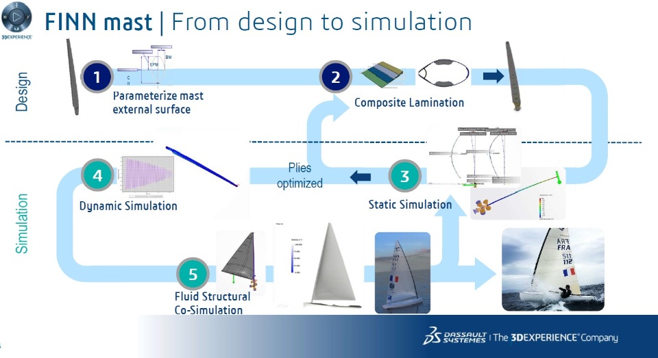

Various steps to achieve

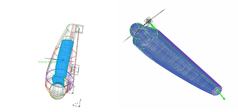

First of all, we have to create a design model with parametric shape & composite layup. We used the CATIA applications (Generative Shape Design and Composite Design) to define a range of parameters to optimize. The parameters are useful to create an optimization. We will talk about that in further episode!

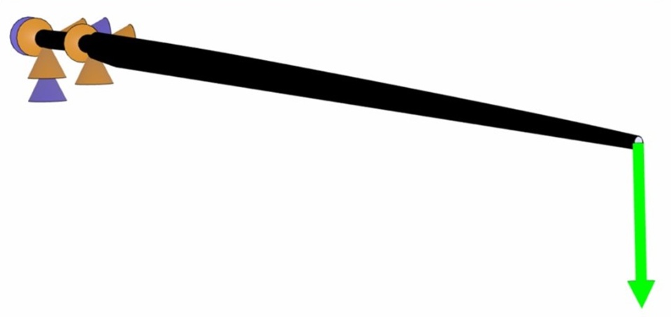

Then, we run the static & dynamic simulations. We will have the opportunity to discuss more about that in couple of weeks!

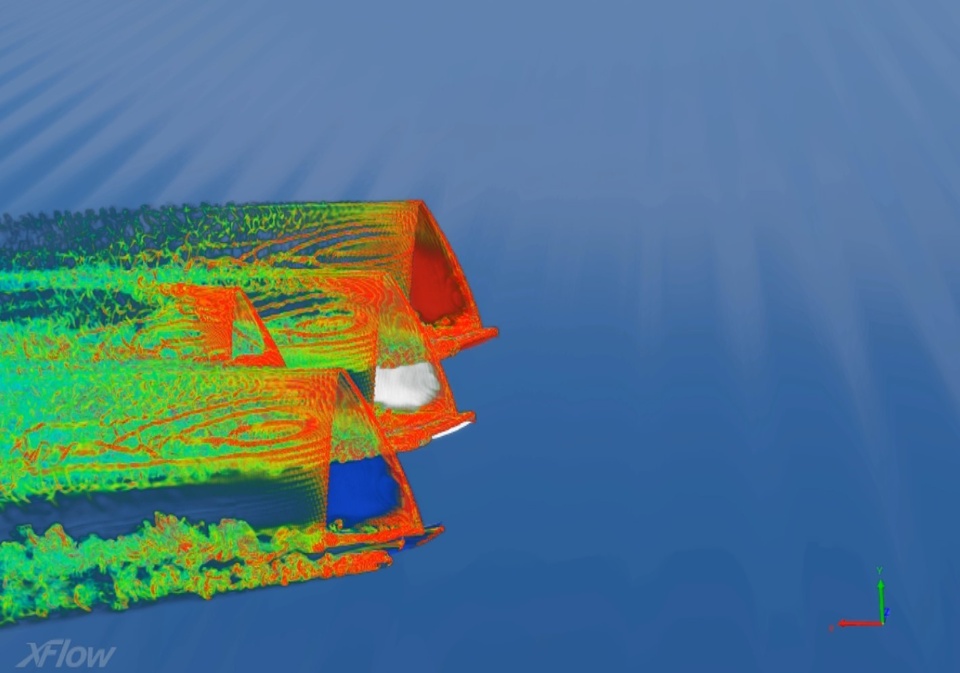

To ensure the realistic simulation of the structure along the sailing, we run complex fluid structural simulation.
After the manufacturing, let’s get on water to test the mast in real wind conditions!
