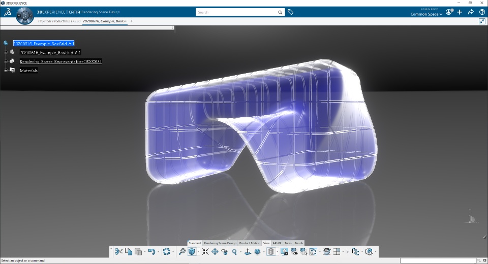

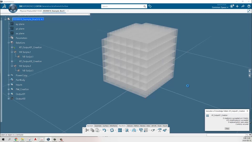

This Video Example shows the Idea of Box type Grid Automation with EKL
Key Point
1)Create Box Shape Grid Power Copy by measuring Mass X,Y,Z length. and Build a Template with a list with Outputs that will be used as Next Template input.
2)Build a Detail Power Copy that if cross each other between Box Grid and Mass.
4)Build a Template and Outputs list from 1) will be input for this Template.
3)When you change Mass, update the process with keeping your Design Intend.
Thanks to Hector Camps, President at PHI Cubed Inc., &Miami Dade COLLEGE for the collaboration.
