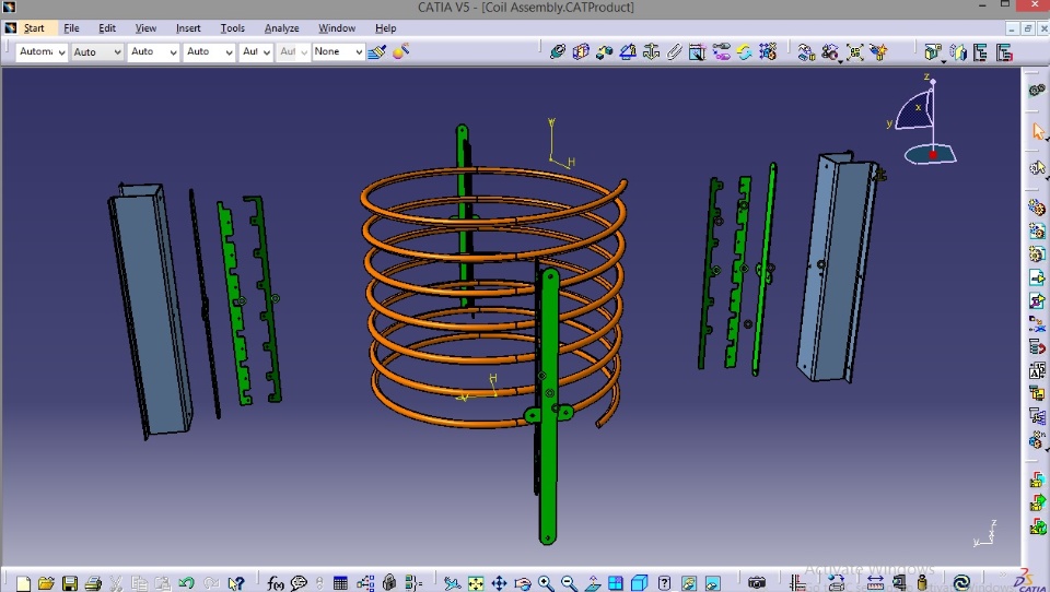

Designing a copper tube coil for a hydrogen refrigerator in order to keep some metal parts below zero to -25 degrees in order to be transferred to the production line (of course, it is used for some special materials).

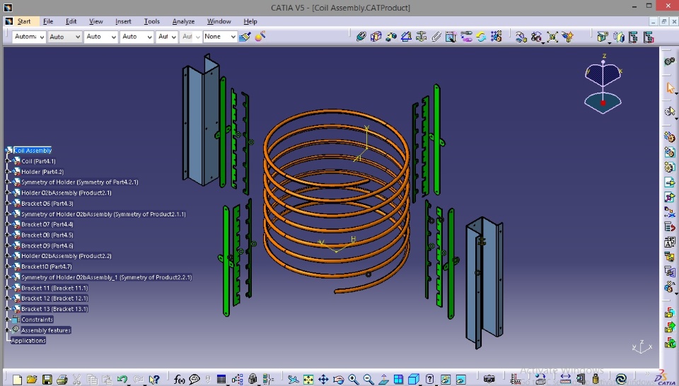

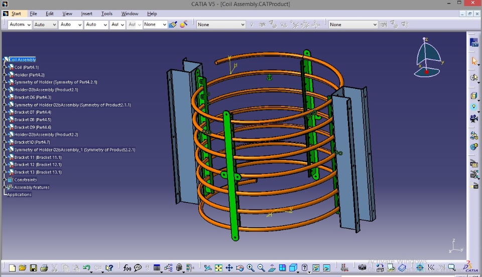

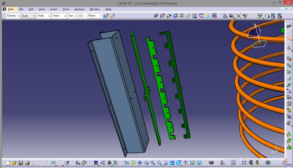

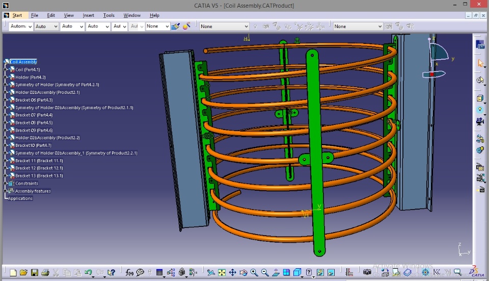

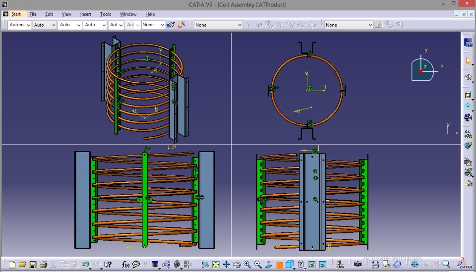

In this project, 4 holders with different pitches are used to keep the twisted copper pipe with a specific pitch, and the whole set is installed inside the pre-designed tank using two main bases.
CATIA software
