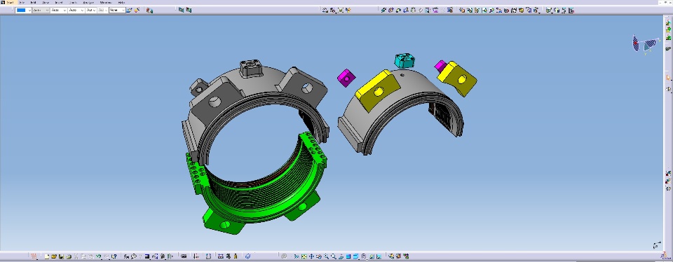

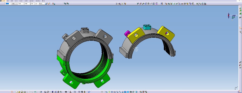

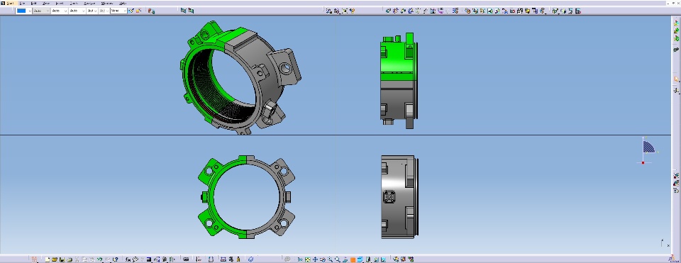

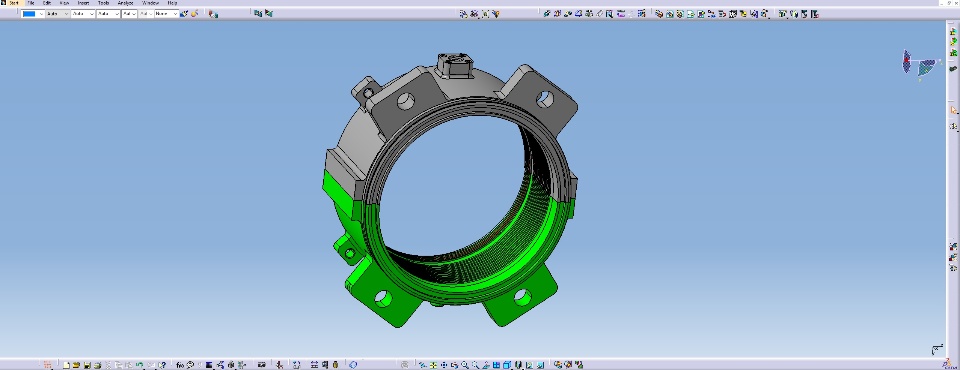

In the modeling of this valve, it consists of two parts, and according to the existing requirements and tolerances, we slightly changed the manufacturing method. Front and back, as well as the plates on the top and bottom of this valve, have been prepared separately by the method of laser cutting and wirecut, etc., and the accurate welding of these parts is done using a fixture.
This method is both economical and time-saving.
