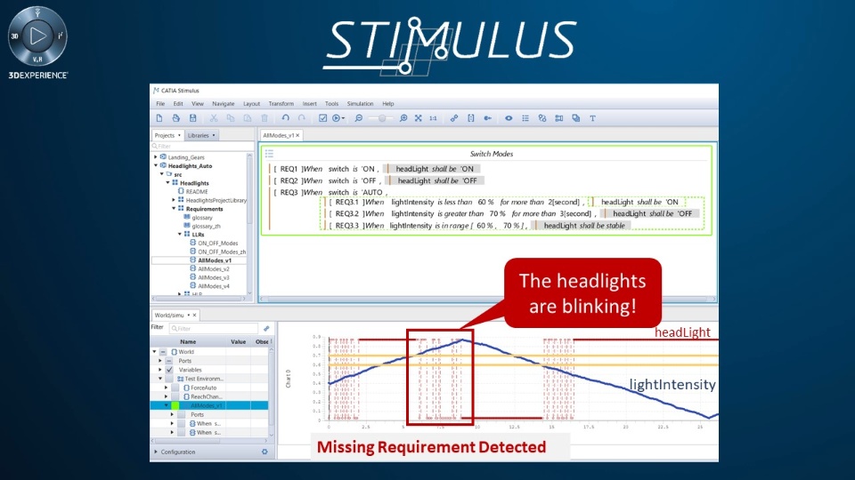

  1. Validating the functional requirements:
Expressing the functional requirements using natural language restricts our ability to validate them predominantly to manual review. There is also the option of Formal languages, which provide precise semantics and allow powerful analysis. However, system architects do not have PHDs in formal methods, which makes such an approach very difficult to deploy to say the least. Semi-formal notations such as SysML are very useful for a number of objectives, but do not allow automatic test cases generation, and all organisations using SysML continue to write textual requirements as not all functionality can be described by a model and both notations are complementary. Textual requirements are here to stay, so they need to be made more trustworthy.
