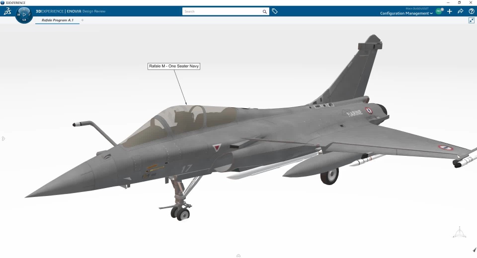

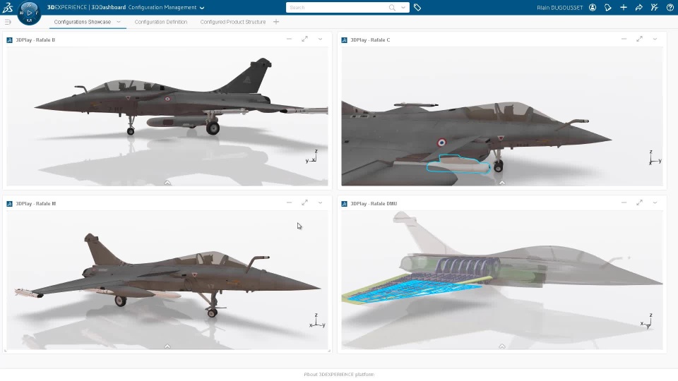

This example is "based" on the Dassault Aviation Rafale french fighters, which has (I will keep it simple) 3 main variants: Rafale B, C and M, described hereunder.
You can also see in this picture and this video the DMU developed for this demonstration, with some bulkheads in the fuselage driven by a skeleton.

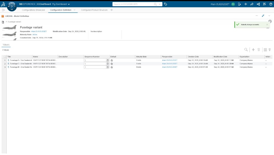

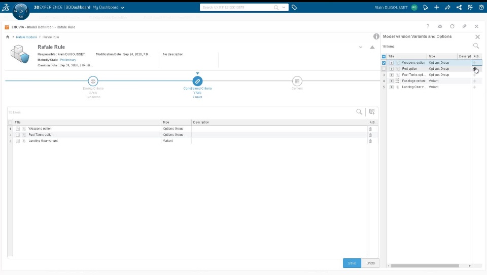

Configuration Management

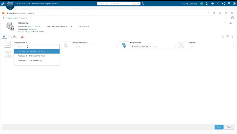

Before going into details on the 3DEXPERIENCE CATIA side, we will start with the creation of variants and options thanks to ENOVIA Model Definition application.
The following steps are then to create Model Version, rules...

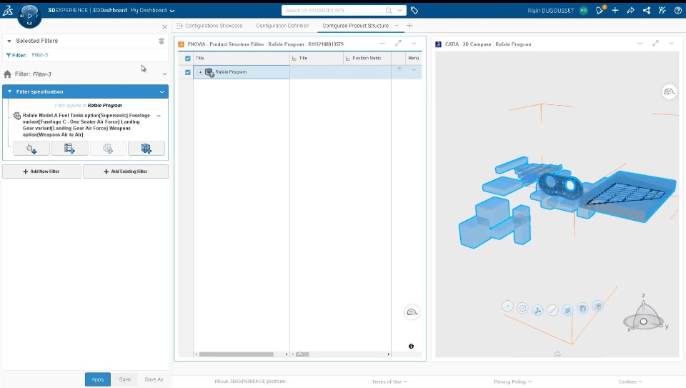

...and Product Configurations that will allow to filter the Product Structure.

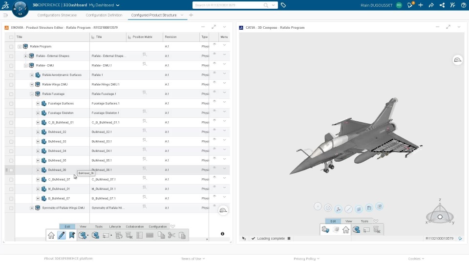

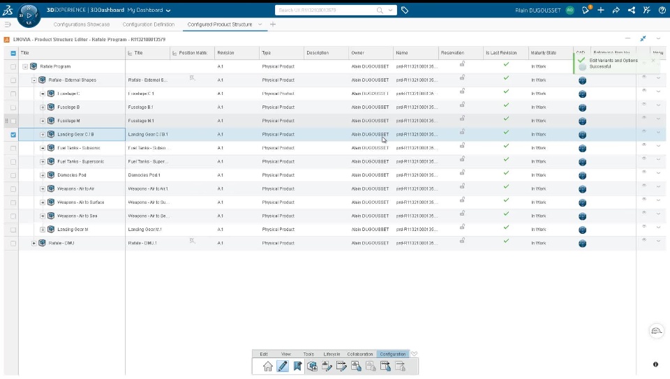

Once Model Version (with its variants, options, rules and Product Configurations) has been defined, it then possible to associate it to a 150% DMU of the airplane and to specify effectivities of each instance.
That is to say to specify in which cases instances are available, or not. All these operations are performed in ENOVIA Product Structure Editor application in this video.

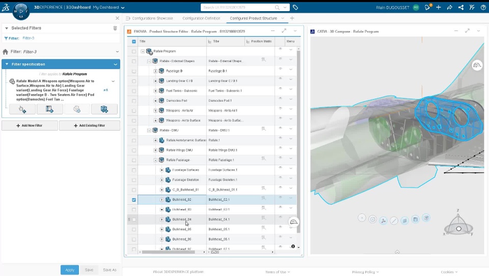

It is then simple to filter the Product Structure of theRafale plane using predefined Product Configurations.

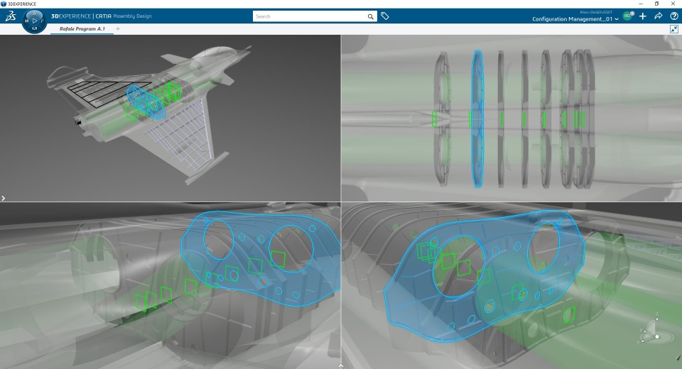

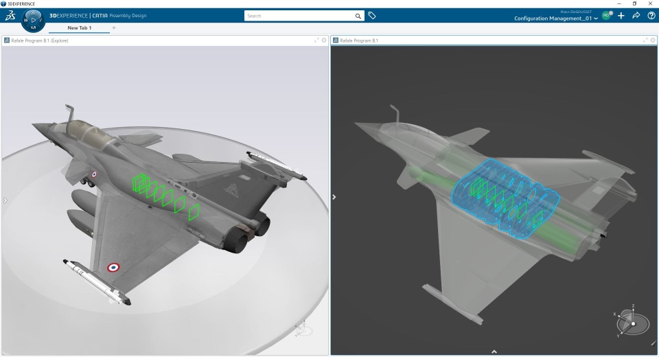

Use Case 1: 1 skeleton driving 1 bulkhead used into 2 Product Configurations
All this being done, we can now jump back to our beloved CATIA applications, with a first use case in which one skeleton part is driving one (or several) bulkhead(s) used into two different Product Configurations.
- The first step of the following video is to opened the filtered Product Structure (using one Product Configuration, the Rafale M one) into Assembly Design to performed a modification of the skeleton. And then an update of a bulkhead driven by this skeleton.
- Going back to Product Structure Editor, I filtered Rafale Product thanks to another Product configuration, Rafale C, which "contains" previous skeleton and bulkhead.
- Opening these filtered data into 3DEXPERIENCE CATIA, I can check that everything is ok: skeleton and bulkhead are up to date, and links inside this last one are synchronized.
