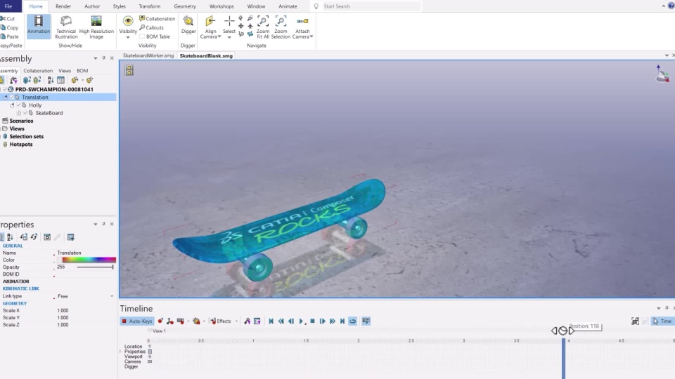

As promised, here is the first in hopefully a long series of TodCasts revisited. This is a re-do of one that I did way back in 2012, showing how you can create complex animation movements by using multiple levels in assembly animation. The concept is simple but you can achieve some very interesting results by just breaking down movements and animating the assembly groups versus trying to animate the parts in Part mode.
