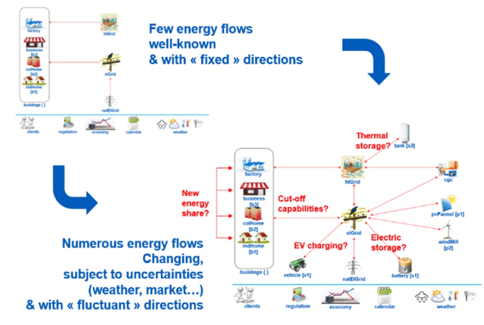

Study the future evolutions of an energy system, from a centralized network to interconnected multi-energy networks:
- Design more efficient architecture for the energy system with facilitation of co design of the energy systems
- Size of sub systems, based on legal and operational constraints
- Integrate these systems together
- Optimize operations for eg. electric vehicle charging, electric storage, thermal storage, manage cut-off, etc.
Approach - From centralized to de-centralized energy management (source EDF)

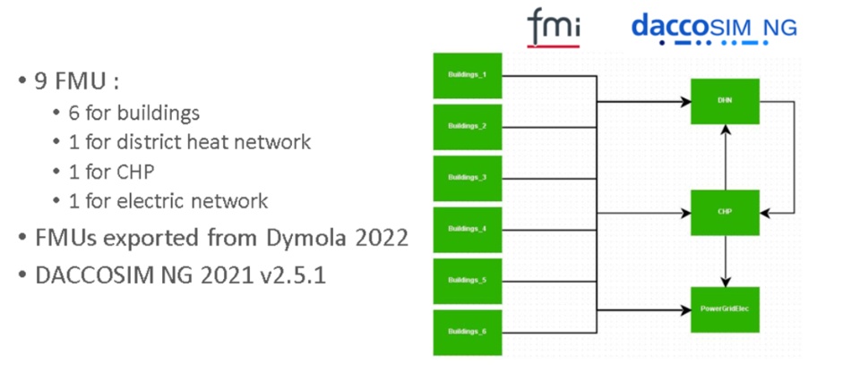

- Several Modelica libraries enhanced and / or created , including DS EPSL library enhanced
- All development made with CATIA Dymola with use of enhancements (described in previous posts)
- The complete model is spitted into FMUs exported by Dymola, and co-simulated in DACCOSIM NG
- Total size : > 500 000 equations
- Simulation time intermediate results
Extract - Full district model with building envelope and energy system coupling (source EDF)

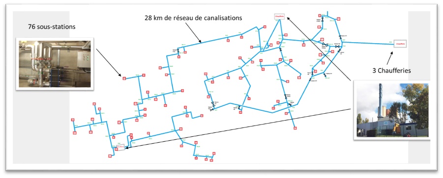

ENGIE Lab Cylergie studied the design of heat networks from production to consumers, in two cities:
- Balma (Toulouse suburb, Aquitaine),
- then Rillieux (Lyon suburb, Rhône Alpes).
Overview of Rilleux network in Aquitaine & Rhône Alpes (source ENGIE)

- 2 steps approach : Balma : small size network, then Rillieux with a larger size
- 3 different boilers, pipes network, Heat exchangers at buildings, storage
- n x 1 000 apartment rooms equivalent
- Parameters and calibration with data from the field

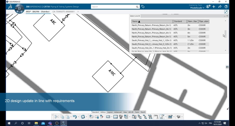

- Extension of the case study in 3DEXPERIENCE

- 3DEXPERIENCE demonstrator inspired from Balma ; scenario to give a larger view from the customer needs to simulation of the updated design
Balma heat network scenario in 3DEXPERIENCE

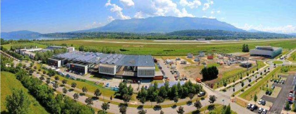

CEA Lab studied the design of a multi energy micro grid, through their own facilities located in Le Bourget-du-Lac - Chambery (Rhône Alpes).
Description
- Address a whole district in CEA premices
- Create synergy between CEA INES teams (disciplines)
- Model multi energy systems with their interaction : production, network, consumption and storage
- Handle a large variety of systems (houses, networks, PV panels, boilers, batteries etc…)
- Create a simulation platform with capability of studies at different grain levels
- Address large models with acceptable simulation time

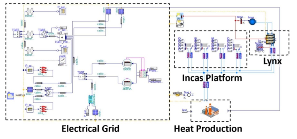

Architecture of the whole CEA INES micro grid (source CEA)
Some details on the technical results
- Library of commercial building model (envelop & insulation, orientation, several floors, rooms, doors)
- 4 different individual houses modeled
- New Modelica library of electrical components;
- Electrical model of the micro grid
- Heat network model with CEA internal library with boilers, solar, PAC, storage, ECS and substations
- All models integrated ; with mix of Modelica and FMU
- Nearly one year simulation scenario done , with intermediate execution time
PV component development and validation (source DPS)
1st level of whole INES site modeling with Dymola (source CEA)
