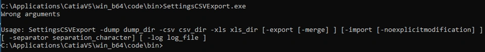

I also found a utility whose name seems interesting: ..\\win_b64\\code\\bin\\SettingsCSVExport.exe but so far, I have not been able to generate any CSV (the usage output is not very helpful).
