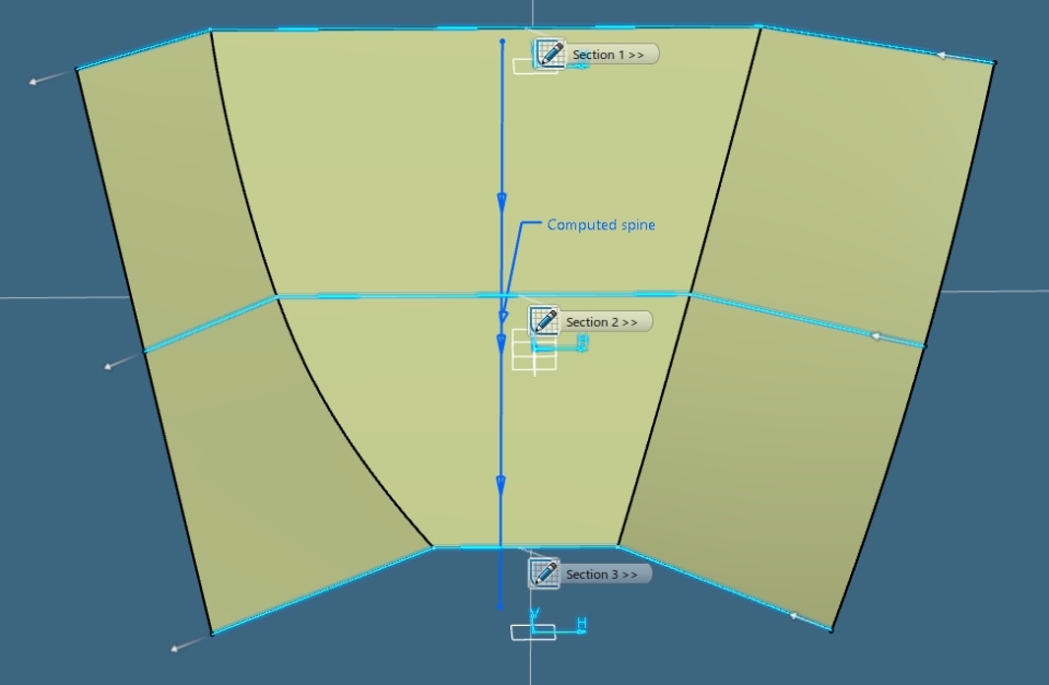

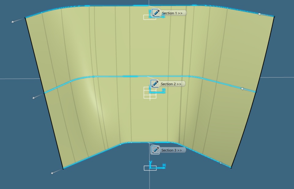

Couplings determine how sections are paired with each other. With using couplings options, in some cases no need to use guide curves, getting surfaces with fewer patches and more quality surface transitions obtained.
There are four types of couplings: ratio, tangency, tangency then curvature, and vertices.
  • Ratio: the curves are coupled according to the curvilinear abscissa ratio. That is, they are coupled in proportion to their lengths. Point on ratio 1/L1 on Section1 is coupled with point on ratio 1/L2 on Section2 where L1 and L2 are curve lengths of sections 1 and 2 respectively. (Figure.1)
  • Tangency: the curves are coupled according to their tangency discontinuity points. (Figure.2 and Figure.3)
  • Tangency then curvature: the curves are coupled according to their tangency continuity first then curvature discontinuity points. (Figure.4)
  • Vertices: the curves are coupled according to their vertices. (Figure.5)
It should be noted that curves with different numbers of vertices are not coupled by tangency, tangency then curvature, or vertices types.
Figure 1. Ratio type coupling
Figure 2. Tangency type coupling
Figure 3. Tangency type coupling for tangent continuity sections
