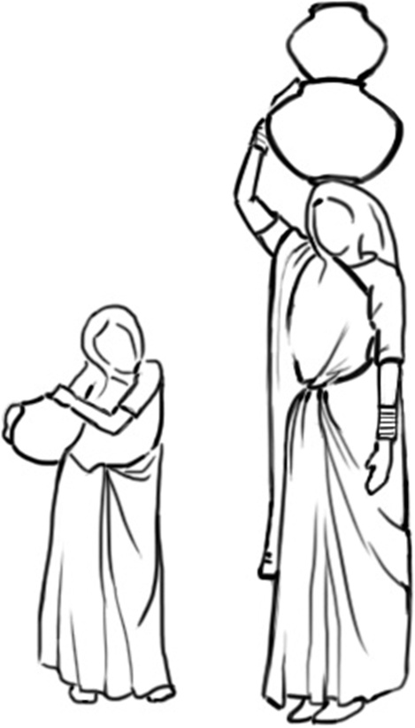

Introduction
Access to potable water in villages is still a problem in India. It has to be fetched from long distances. This task is usually done by the women in the family. They go to fetch water from the well or a pump in the area. This constitutes approximately 50 litres of water per day for a family of 5 members. The most common method of fetching water is by carrying matkas/handas on the head. This form of head load causes a lot of strain on the neck and often is the cause of injuries and muscular spasms.

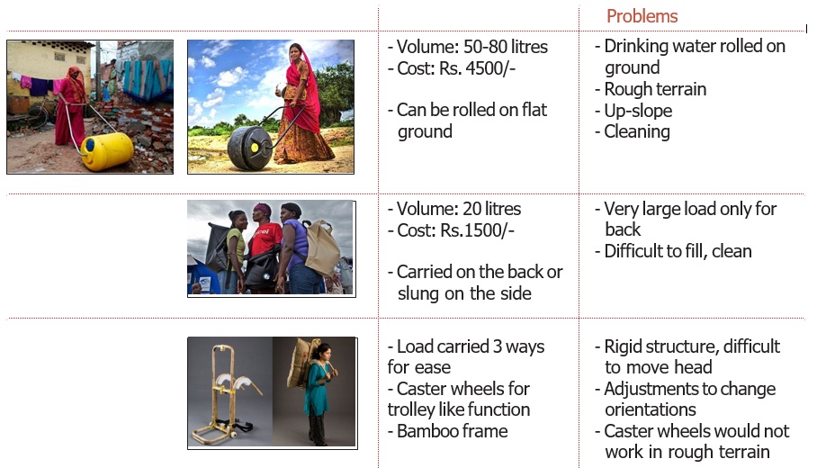

Parallel product study
Inferences from field study
  • 1.Volume of water for a family of 5: 45 litres - No. of trips made per day: 3-4 (for a family of 5)
  • 2.Terrain: Rough, narrow with stones and bushes

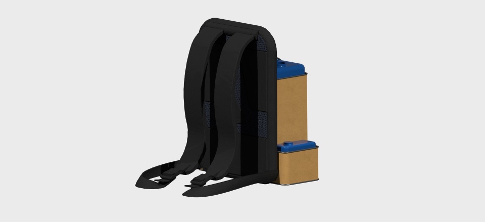

Design Brief
To design an aid for rural women, to increase efficiency of fetching water
1. Should allow to carry 45 liters of water in 1-2 trips
2. Should reduce the effort required to fetch equal amount of water.
3. Should be carried ergonomically by one woman
4. Should allow easy loading and unloading of water
5. Should store water in a hygienic manner
6. Should minimize wastage of water on commute
7. Should be usable over different terrains of different villages.
8. Should allow easy pouring/transfer of water.
9. Easy to clean and maintain.

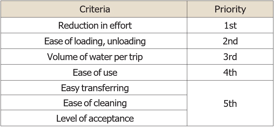

Concept Evaluation

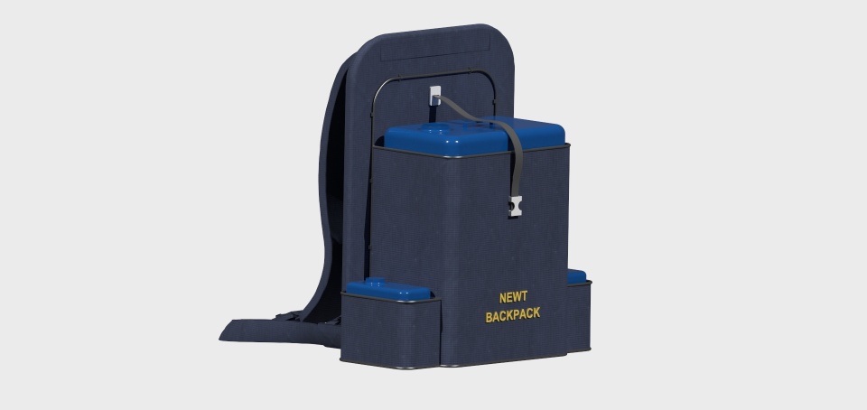

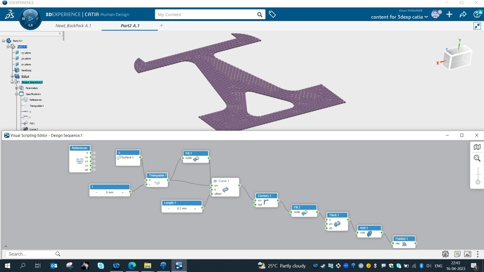

Design Method (Specification & Visual Script)

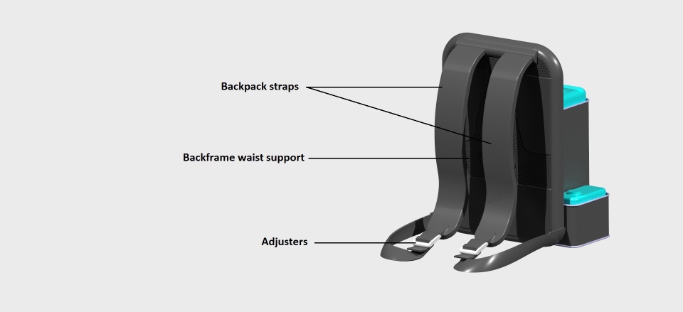

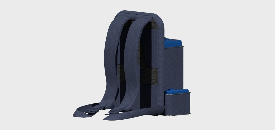

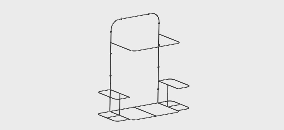

Full frame with support straps

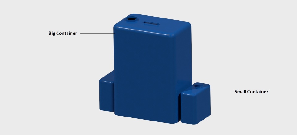

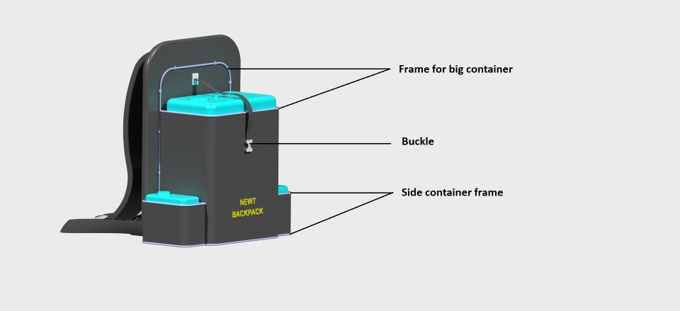

Container

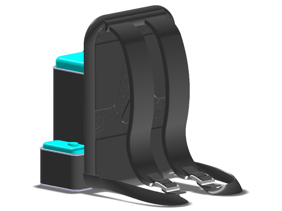

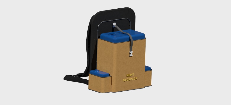

Full Rendering

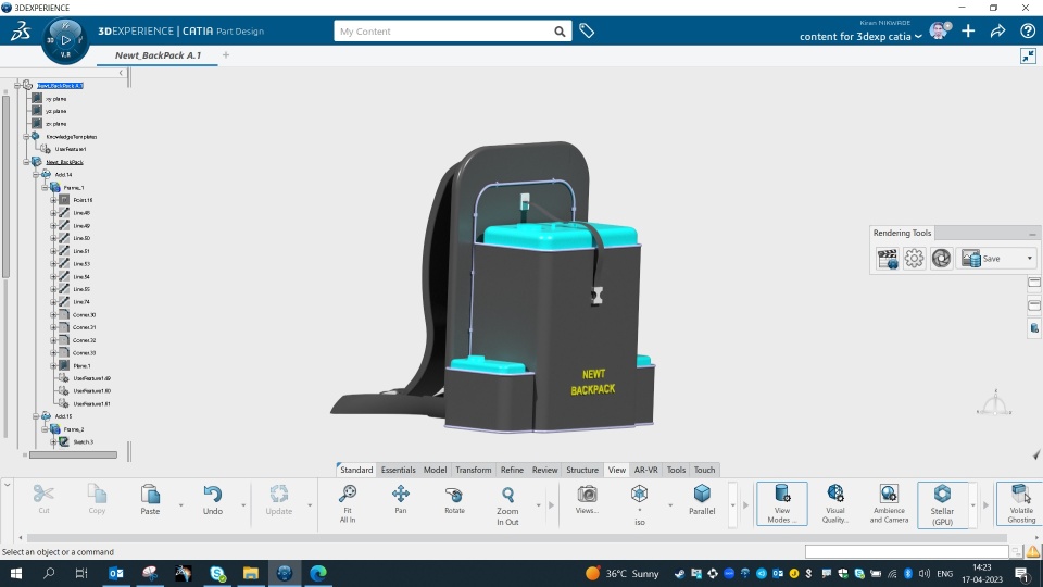

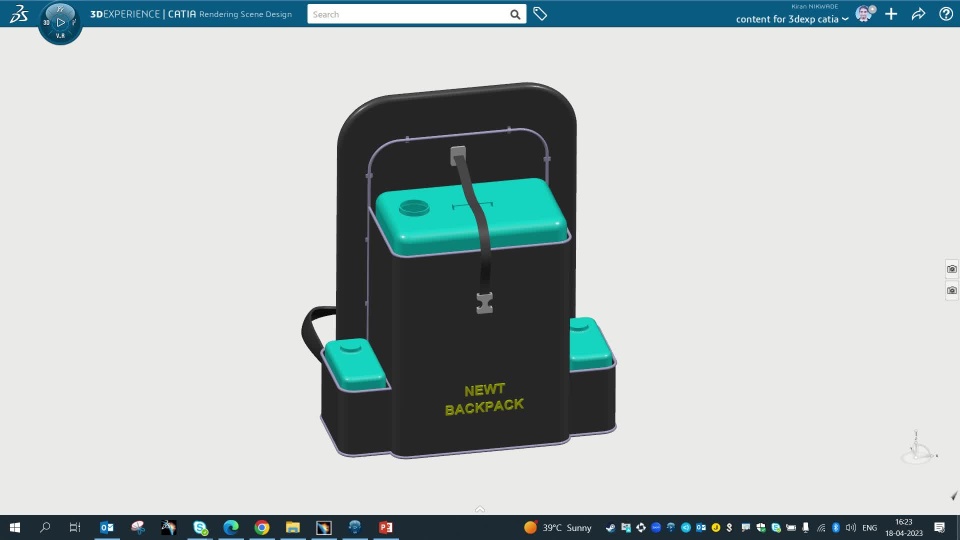

3D Model
