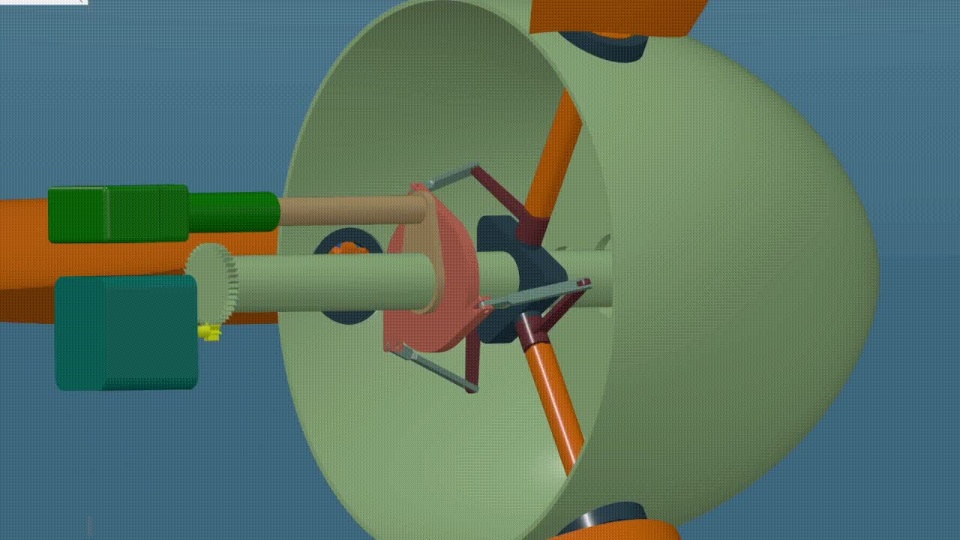

The pitch of the blades is changed by a fixed swash plate mechanism, used in the aerospace industry for propeller aircraft. Apart from being fun to model, this mechanism is very reliable, and transforms the linear motion of the actuator into rotary motion in three axes perpendicular to the linear motion.
The bearings holding the blades in place are slewing bearings, commonly used for this application as they can carry more load than other variants.
