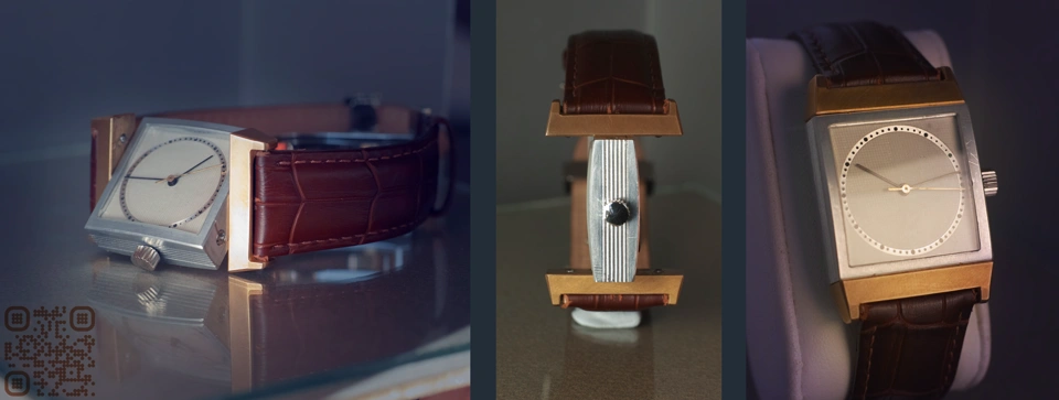

Gideon made the first prototype as a proof of concept. The case was made by hand in his fully equipped workshop which on its own was I source of constant inspiration for me when visiting. The main body was made from aluminum, lugs form brass and it had a working movement inside. Dial was engine turned by him on one of his rose engines.

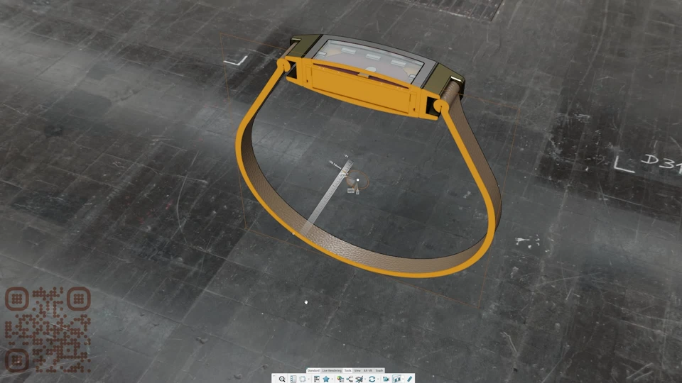

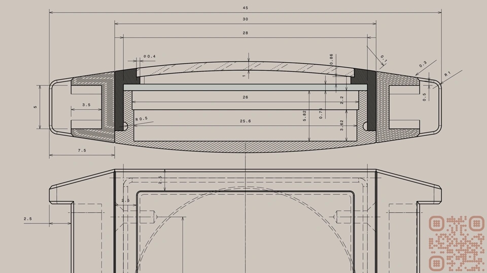

Design was developed and constantly evaluated with the help of a digital twin using Dassault Systèms, CATIA. As an architect, it was very insightful to discover further the architecture of watches and how densely populated and beautifully efficient the tiny world of these precision machines are. Just an art in motion and a lot of common points to draw parallel with my day-to-day work!  Being able to drive parametrically the whole geometry not only made any tweaks to the design very seamless but it allowed us to explore the limits with regard to utilising the space inside the watch, the solidity of the structure and various other design considerations.
As soon as we confirmed the final vision after carefully studying the first prototype, the parts for the case were sent to be CNC machined. The “flip-ability” of the main body is such an unique feature that required many considerations and demanded a design the will keep the geometry well aligned at both conditions, providing enough torsional strength without being overly tight.

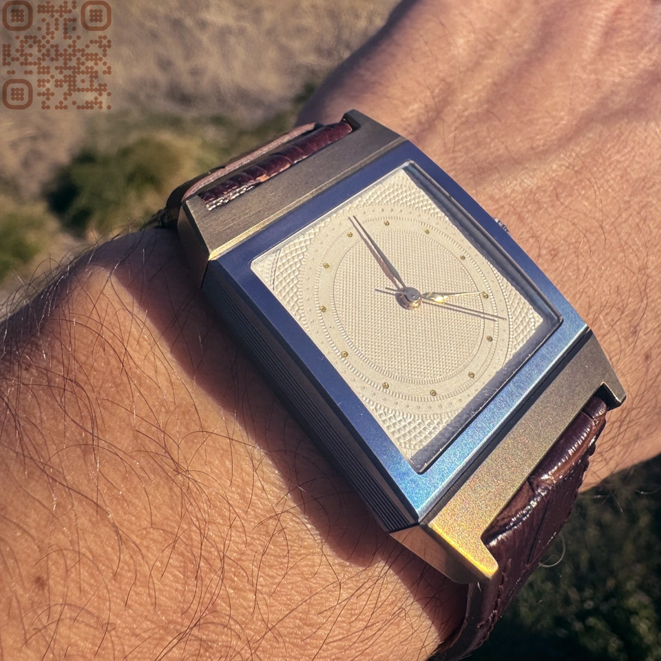

The next crucial part was the dial. Various tests were done on the rose engine and for the final version Gideon had to resurrect a different type of engine lathe that allowed radial patterns to be cut. The dial was made of silver and finished silver plated to achieve the white pristine look and protect its surface.
As I am writing these lines, the watch sits proudly on my wrist. I am very grateful to everyone that took part in and made this happen, including Dassault Systèms for equipping us with some of the best tools for this type of projects! Hence my decision to share a personal story with the community here and use the opportunity to wish to everyone reading best wishes for the New Year!
