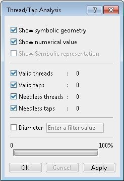

The Tap-Thread Analysis dialog box has below check boxes for analysis:

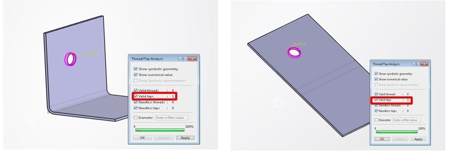

In SheetMetal App, threaded holes consists of Holes created with thread option, Flanged Holes (with Tap), SheetMetal Solids pasted from SheetMetal parts having holes with thread option. This function enables the Tap-Thread Analysis command to detect threads or taps on SheetMetal holes in both the views 3D and Flat as shown in below image.
With Tap-Thread Analysis command the number of valid threads or taps are displayed in the dialog box. After clicking apply button the representations are shown at location of holes with display of thread diameter, depth and pitch. The representations are created in both views 3D and flat at the respective location of holes in that view. The representations created are not persistent, they are lost when the command is deactivated.

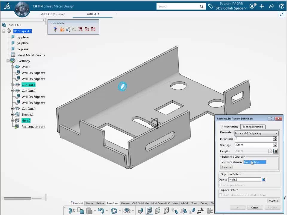

Video:
Let’s see the working of above mentioned command thorough a short video.
