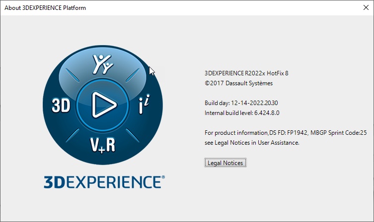

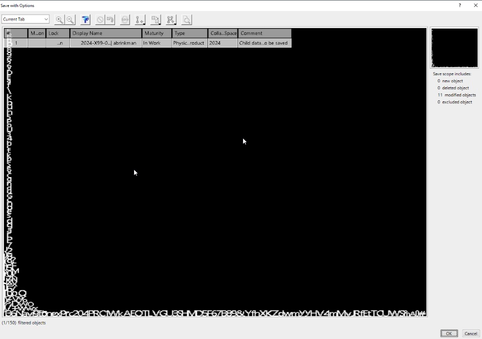

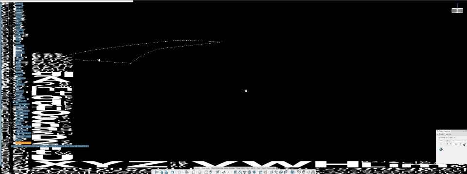

Several users across our business frequently experience an issue where the graphics of 3DX become unusable. See the example screenshots below. This only affects the 3DX application on their workstations. This issue is also not something we have been able to reproduce.
First started
When we upgraded from 2017x to 2022x

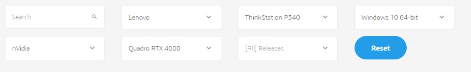

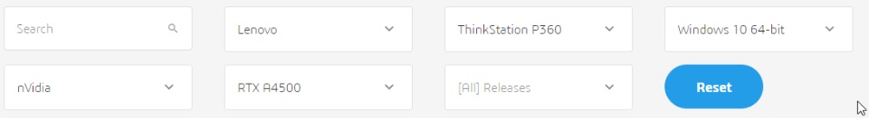

Client Hardware
Lenovo P360 – i9-12900K / 128GB RAM / RTX A4500 Nvidia Graphics Cards
Lenovo P360 – i9-10900K / 64GB RAM / RTX A4000 Nvidia Graphics Cards

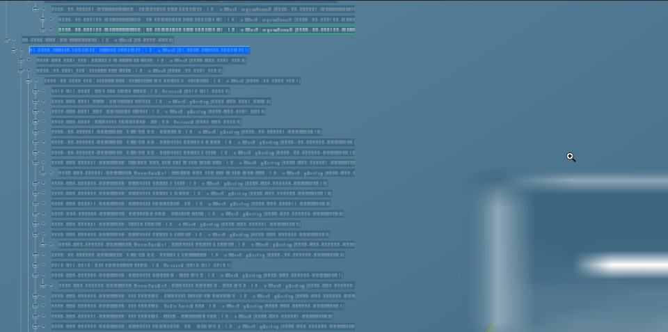

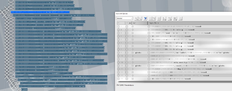

Examples below of what the users see.

Reports from our designers suggest that this may only happen when specific data is loaded into their sessions. However, this has not been reproducible.
