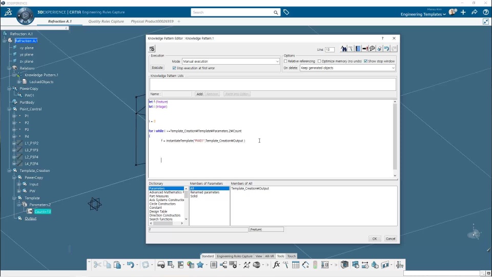

This Video Example shows the Idea of Refraction Automation with EKL
Key Point
1)Create Grid that will be Refract your Line
2)Build a Detail Power Copy
3)Build a Template and Outputs list from Power Copy and Reuse it.
4)When you change Input Sketch, things will update by the process with keeping your Design Intend.
