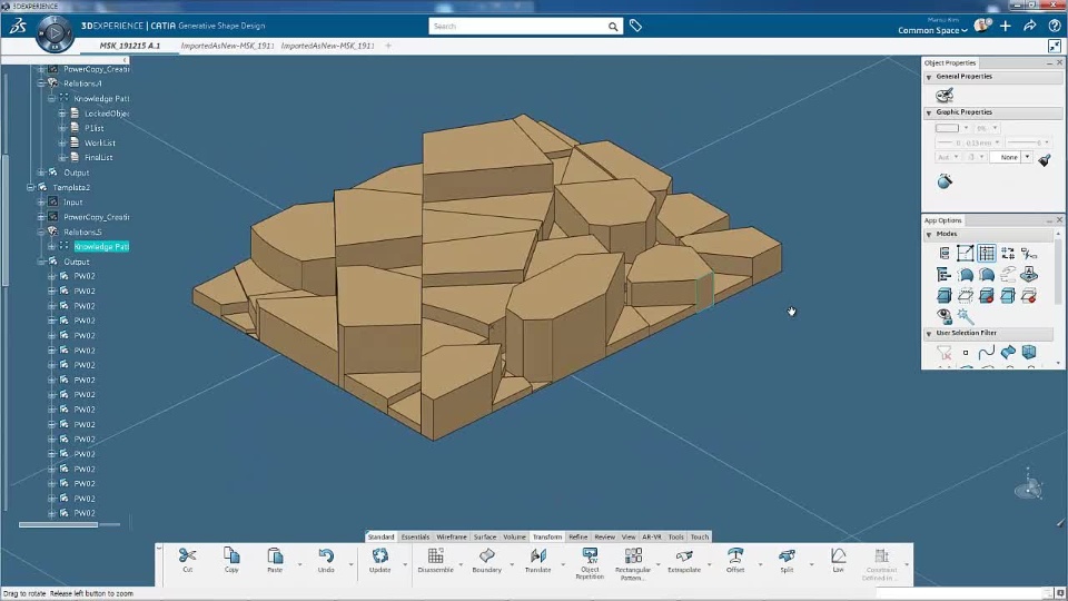

This Example shows how to split the Surface by EKL automation
step
1. Create Sketch and Add them to the List
2. Create Power Copy for Split
3. Use InstantiateTemplate syntax for repetitive work
4. Use If , add and Remove List
aDistance =distance( Asurface , Acurve )
if aDistance == 0mm
if aDistance ▷ 0mm
List ▷Append(OutputA )
List ▷Append(OutputB )
List ▷RemoveItem (1)
Thanks to Hector Camps, President at PHI Cubed Inc., &Miami Dade COLLEGE for the collaboration.
