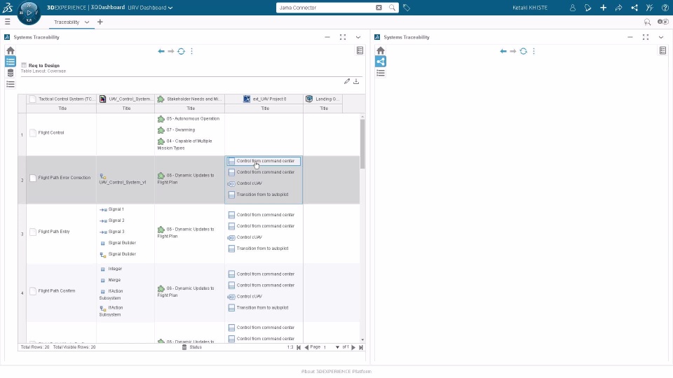

3DEXPERIENCE Platform Integration with Jama Software
Jama Connector starting R2024x FD01 OnPremise is making an entrance into the CATIA Systems Traceability connector's family!
Discover this new feature in video:
