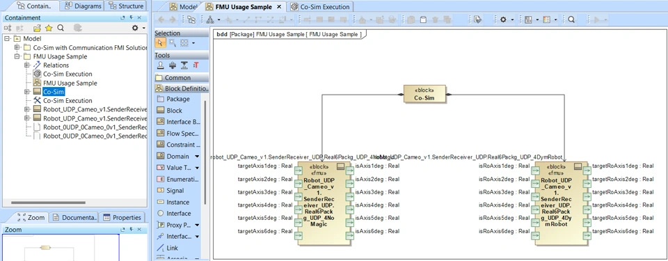

We're excited to share our comprehensive guide and resources on an open modular co-simulation architecture utilizing the FMU communication interface! This powerful, customizable interface can be easily generated by you, enabling seamless integration across hundreds of tools and interfaces—including Catia Magic (SysML simulation), UDP, TCP/IP, LCM, MQTT, shared memory, and serial ports.

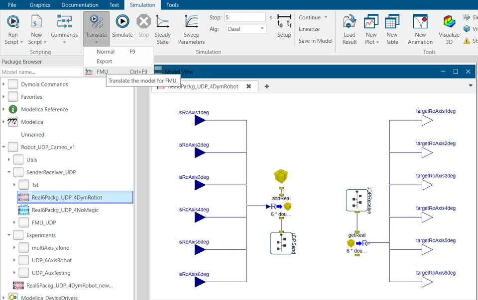

  • Step-by-step guide to generating communication FMUs with Dymola

  • Architecture and FMU usage sample in Catia Magic project:
  • Dymola project for FMU generation (unzip):
  • Sample sender / receiver fmu ready to be used (unzip):

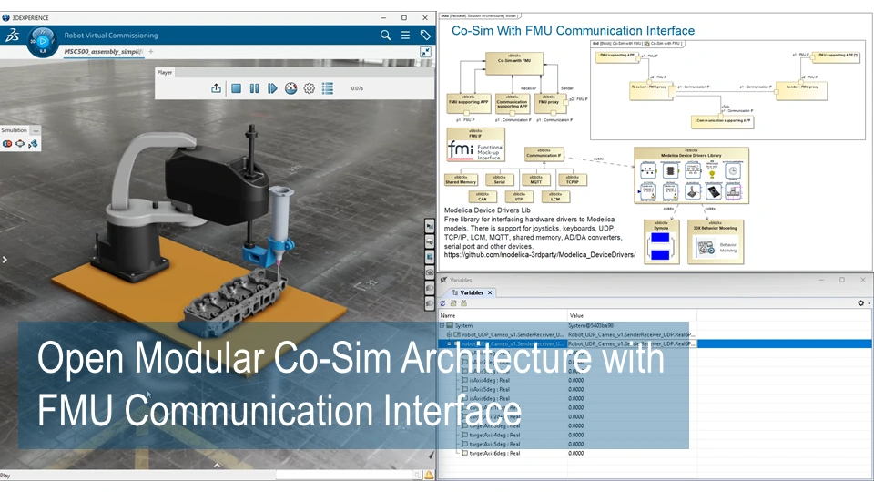

  • Dive deeper into the Modelica Device Driver library: https://github.com/modelica-3rdparty/Modelica_DeviceDrivers
