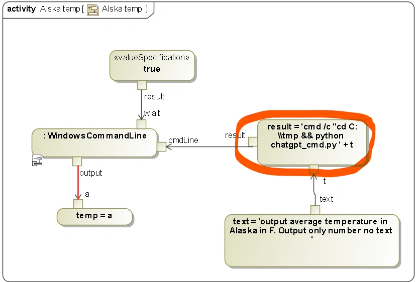

In this video and post, we demonstrate a simple yet powerful method for integrating AI into SysML simulations when external logic needs to be part of the process. This includes working with random data, external datasets, or component imitations.
This amazing approach enables you to create custom components with defined inputs and outputs, facilitating early simulation activities. These components can seamlessly integrate into your system architecture for more robust and dynamic simulations. Additionally, the method showcases how to execute external scripts, such as Python, along with any required libraries.

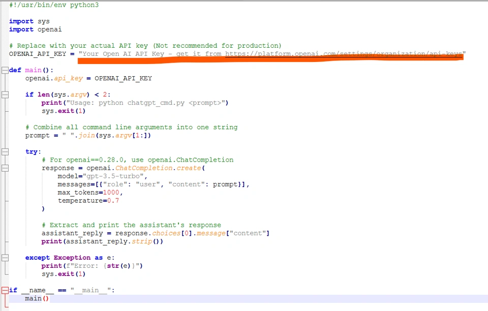

  1. Download Catia Magic project file and python code.
  2. Place them in required location, by default. C:\\tmp

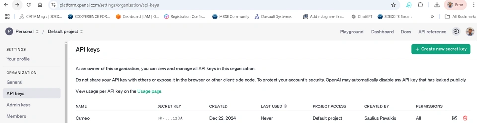

  3. Create Open AI API key at:
    https://platform.openai.com/settings/organization/api-keys
    note: you will need paid account to create API key.
  4. Add OpenAI API key into python file
5. Adjust model if your python script is in different location then C:\\tmp
