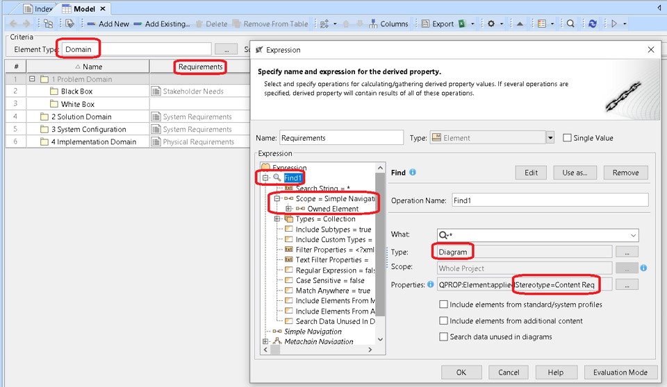

This how-to demonstrates how to create and use it using Structured Expressions. Please find sample based on MagicGrid.
Video:
https://youtu.be/XbVVHISq7Kw

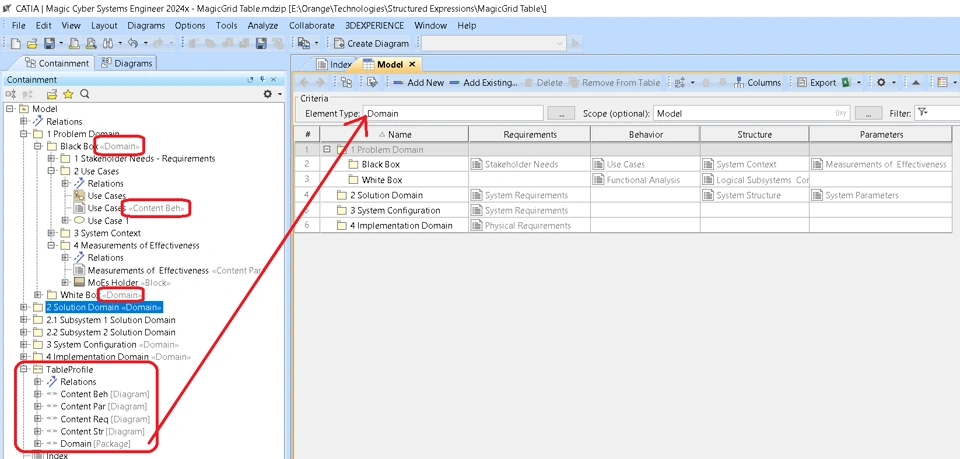

Create stereotypes and apply them on Domain packages which you want to see in the rows, and on content diagrams which you want to see in the columns. Do not forget to put your stereotypes into profile type package.
Create structured expression queries for each table column using simple expression looking for owned elements and using this simple query searching for diagrams with ContentReq, ContentBev etc stereotype based on column.
