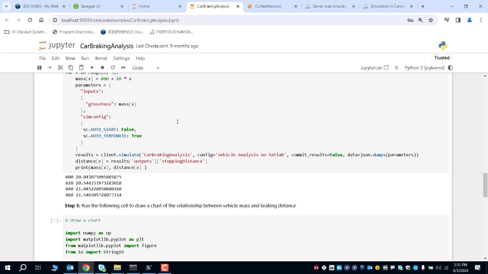

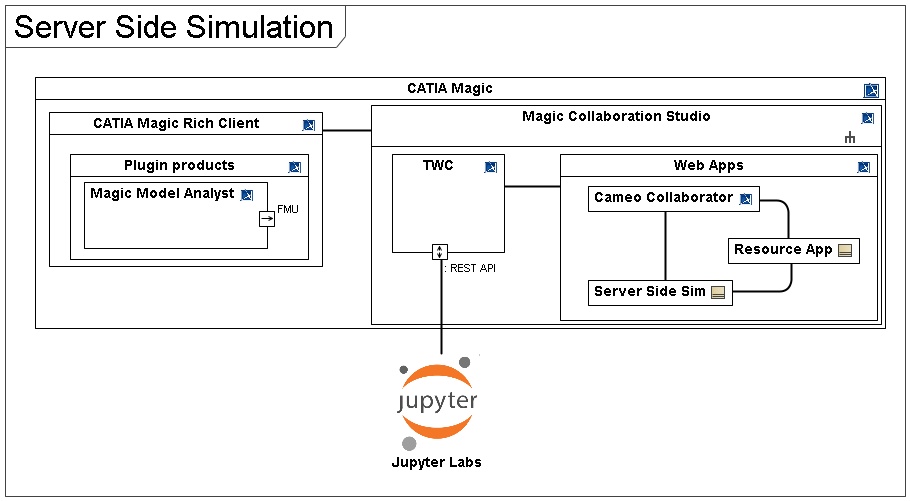

If you work with Teamwork Cloud projects, you can simulate them on the server without using a modeling tool. You can execute your models using REST API, or the Cameo Collaborator for Teamwork Cloud user interface (if there are Cameo Collaborator documents published from those models).
The core benefits of server-side simulation include
  • Tool-free simulation
  • Significantly faster simulations, quick "what ifs" analysis to support SE decisions
  • All time-consuming and resource-intensive analyses done on server
  • Can integrate/expose one's SysML model execution to other SE domains
In this demonstration, we take a live look at the features and capabilities of server-side simulation across all 3 of it's possible avenues of utilization. A more extensive sample with additional features, will be presented at MCSS 2024.
