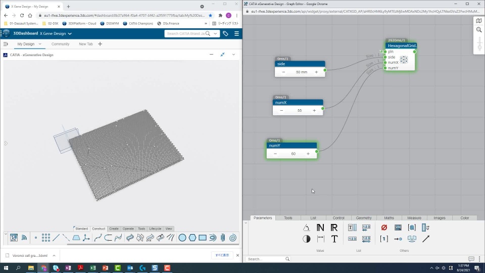

Here is a tutorial on how to create a gradation per domain on hexagonal grid
modeling workflow is as follow:
1. create base surface with domains - Voronoi is used
2 create hexagon grid of points

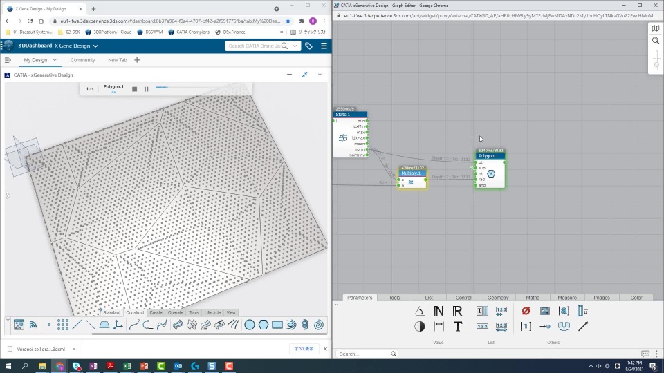

3 group the points per domain - islayingOn + indexOf
4 create curve attractor from the domain's boundary
5 set the attractor curves to domain's points (the ones laying on) - "curve attractor" and "apply attractor"
6 normalize the value of the impacted center translation - "Stats" + "Threshold"

3dxml result is stored within the zip file
going further a little, domains could be defined by list of sketches like below.
