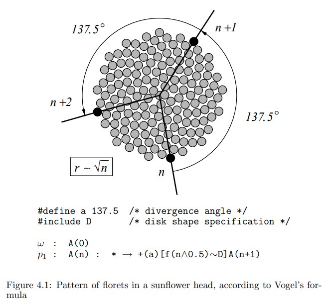

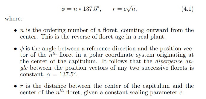

the first model is the sunflower, which I struggled with, a few years ago... the book presents the Vogel's L-system formula for sunflower distribution of central seeds.
A (n) -> +(a) [f(sqrt(n))~D]A(n+1) (below)

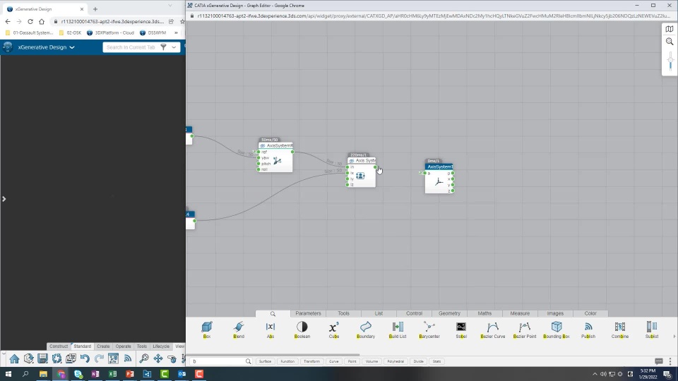

but this can be easily put into equation with n only...
then no need for loop!!! and with the turtle (axis system yell/pitch/roll), the modeling became simple. so I could make a Tutorial out of it.

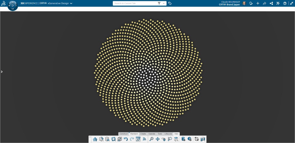

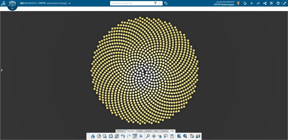

what is puzzling, even by any logical explanation, is the sensitivity of the angle parameter
137.5deg is perfect... +1 deg or -1 deg shows nice Fermat's spirals but so different visually...
