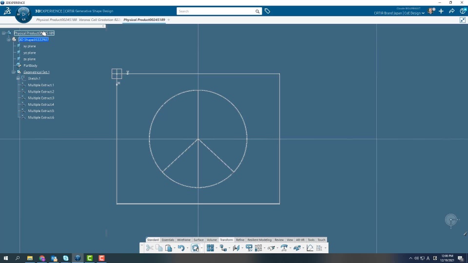

following the question of @DM , I included the part where I extract the domains from a sketch. the point is that I use 3DX Native App (Part Design sketcher) to do it and then multi-extract, but there could be other ways (series of extract + final join for example)... please let me know if still unclear or if you don't have access to the functions (license issue)

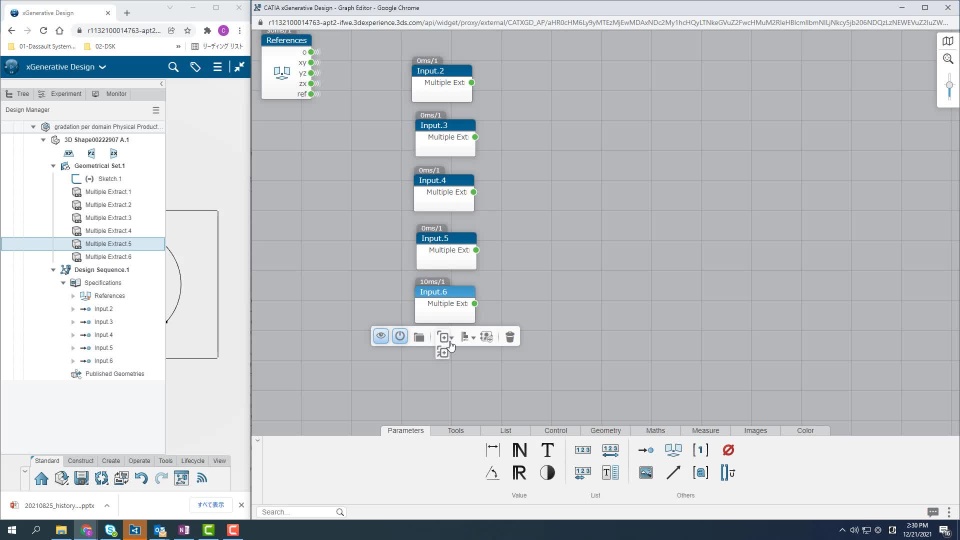

1 create the input with sketch in native app CATIA and extract them into features

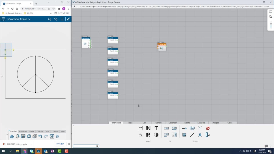

2 open in the model in XGEN and create the inputs
3 create the domains

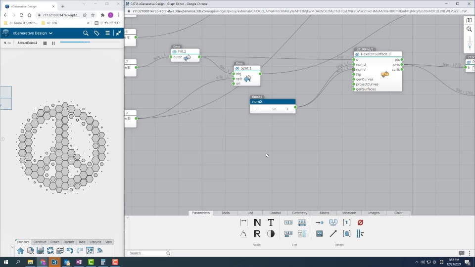

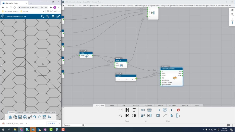

4 create the Hexagon grid -> dont forget that to get a regular hexagon there is cos(30deg) ratio between Height and Width

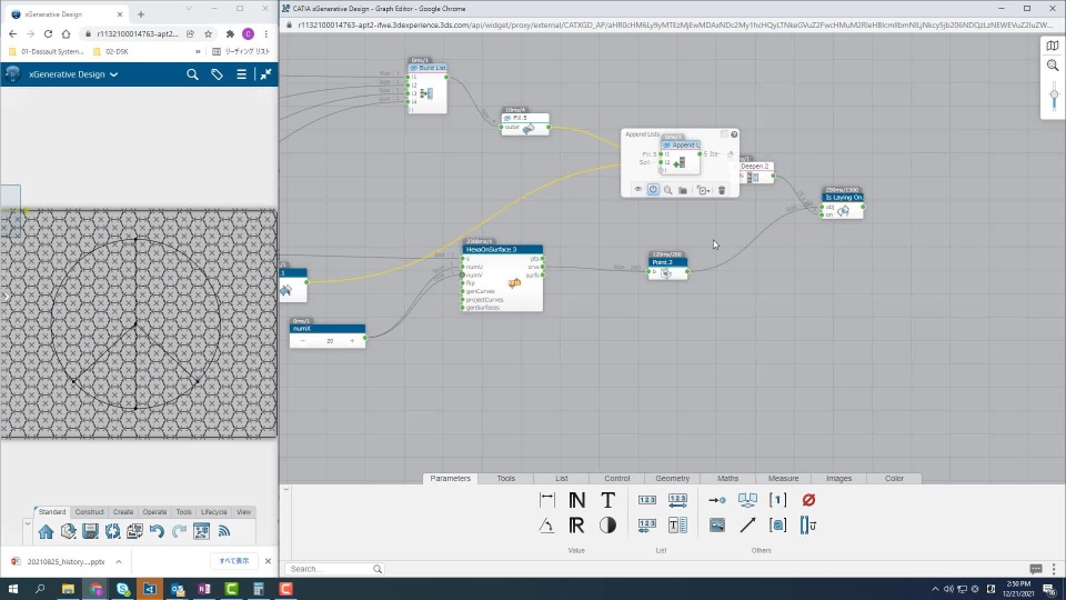

5 Filter Hexagons per domain

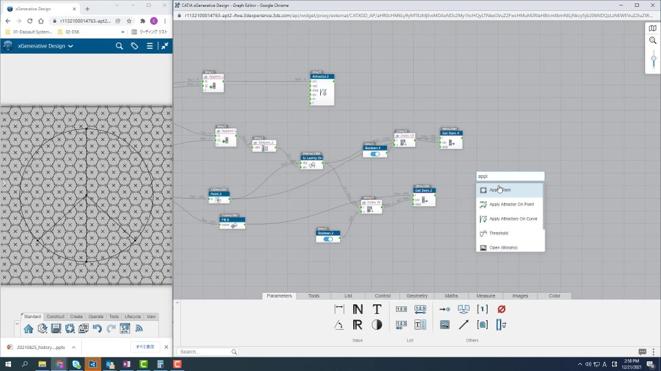

6 create the attractors

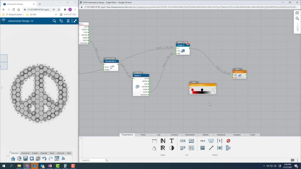

7 make final adjustments with Stats and Threshold + coloring
8 increase the number of Hexagons
