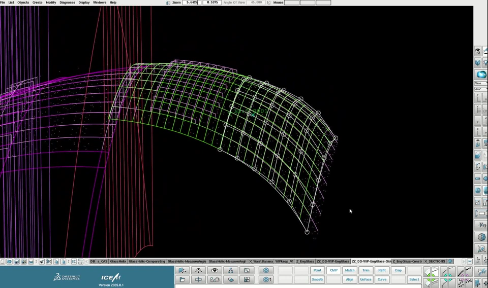

  3. This is really annoying - patches remain selected after you have finished editing control points. This has happened to me on several occasions during training over the last 3 weeks, and thought it was my machine, but others have also reported it now. It is still active in the graphics, as when you change Display settings - selected - it changes the patch display (ctrl points off for example). But if you try to select it in Modify - Patch - CtrlP it wont select it. You can match into it, so the geometry edge is available. Save + Compress sorts this, but we have Reference Manager open 100% of the time and this is a real nuisance to resolve. It will stop us deploying.  It happens at random times, so not always reproduceable. Video is attached.
