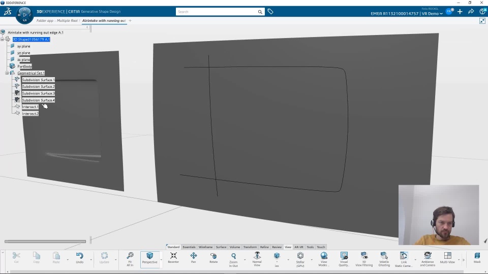

in this video I want to show new interesting ways of using CATIA Hybrid modeling - mixing capabilities of different Apps and modeling approaches to create your model faster and with better quality.
One of the big strength of CATIA is that all Surfaces you create are real CATIA Surfaces - no matter if they come from Subdivision Surface Modelling with IMA or CATIA Nurbs modeling with i.e. Generative Shape Design - all CATIA features work on all those surfaces.
In this example of an Air Intake like structure we will make use of exactly this interactivity to produce our geometry very fast and with very good quality and robustness.
