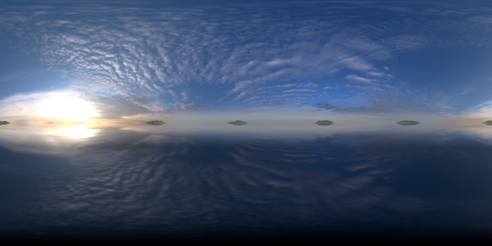

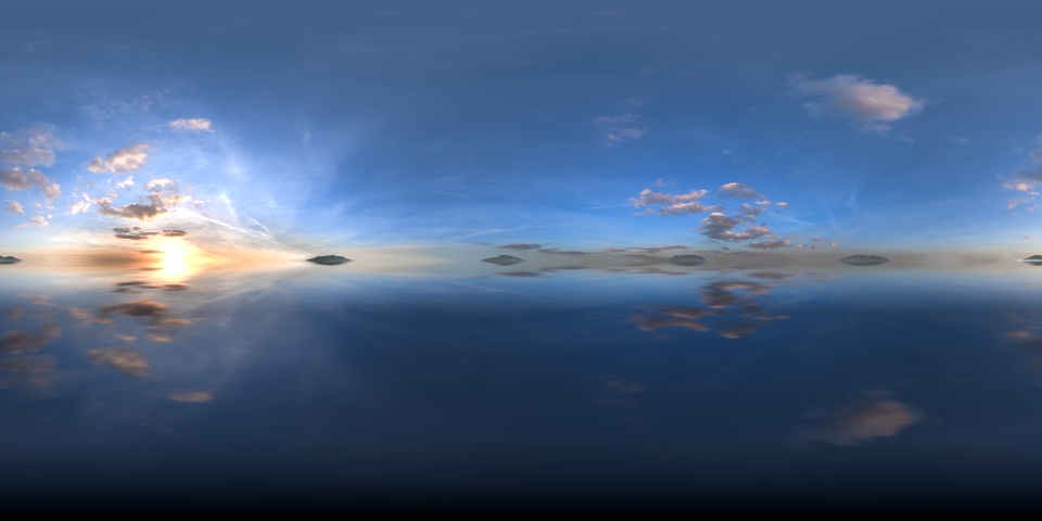

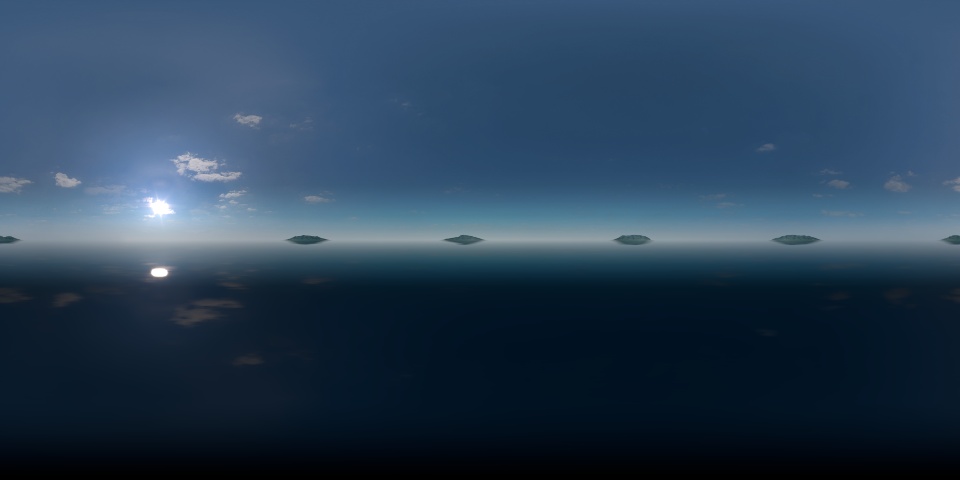

-360° Image & lightning:
HDR of 3 Seas environments
ocean_env_spherical_hdri_ 7 7ocean_env_spherical_hdri__928ocean_env_spherical_hdri__735

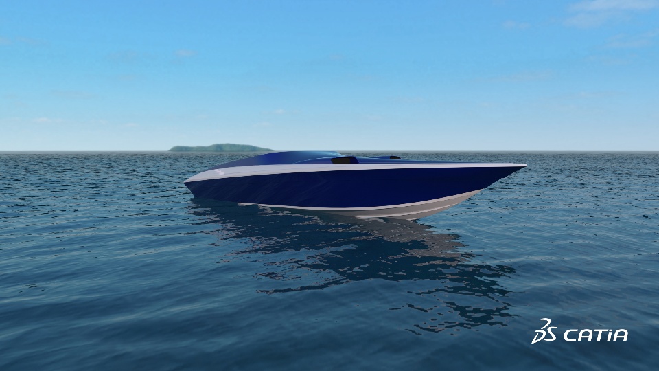

In order to create Yacht Rendering you just need to combine them.

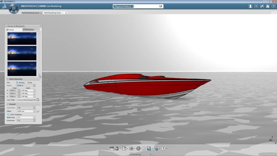

Setting up of the HDRIs:
Turn the parameters as follow.
  • FINITE
  • Radius= 500
  • Rotation Z = -58
  • Scale = 0,08
  • No Shadow
  • No reflectivity
VIDEO TUTORIAL
Here is a short tutorial to show you how to do it :

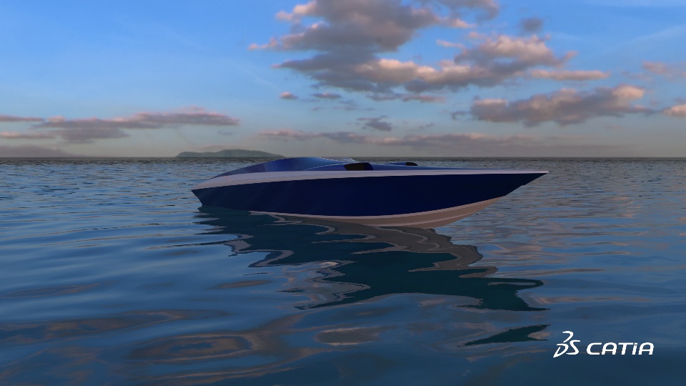

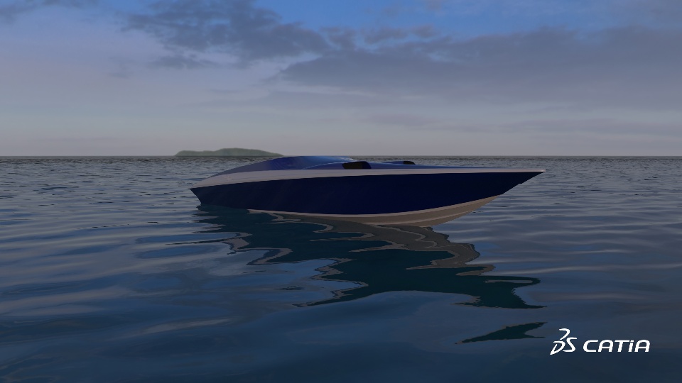

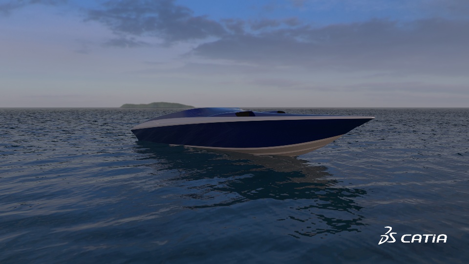

Here are the 4K Results:
735
9287_7
