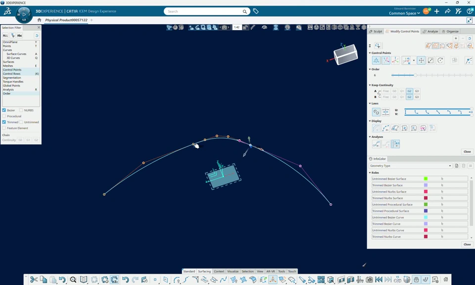

We have noticed since the 2026X-FD03 update that the selection of control points is particularly difficult with some strange results.
We have assigned Control point transform to Spacebar in Preferences. And using InfoColor env variable in env.txt
Two videos showing:
  1. Robot jumps to a different control point to that selected
  2. When selecting a single control point on the end of a curve that has an adjacent curve - blend in this case - it does not pop up the table selector to ask which control point to move - in 2025X-FD05 it always did this.
  3. When selecting more than one control point is it very hard to see them selected - robot is on first selected which is fine.

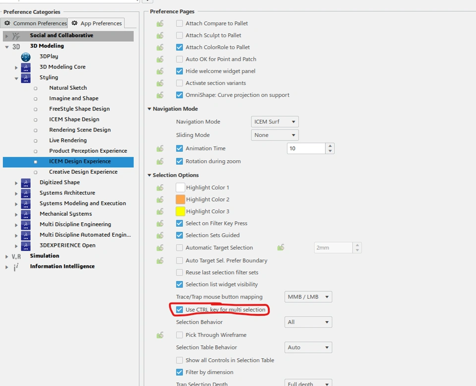

Silvain Carre Nick Mcferran Are there Preference options now that control this?
Trying a few options, one of our users discovered if this Ctrl option for multi selection is OFF, table does not appear. I checked mine and it was ON but still had the same issue. Turned off then back on again and table selector worked again.
