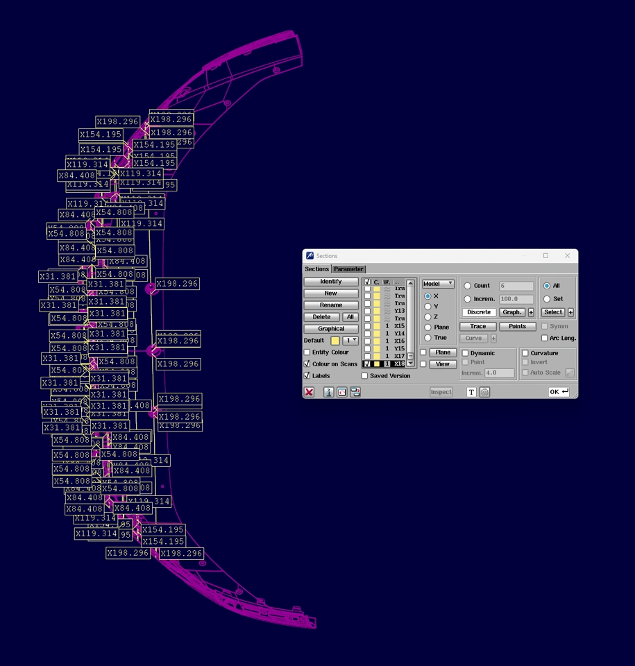

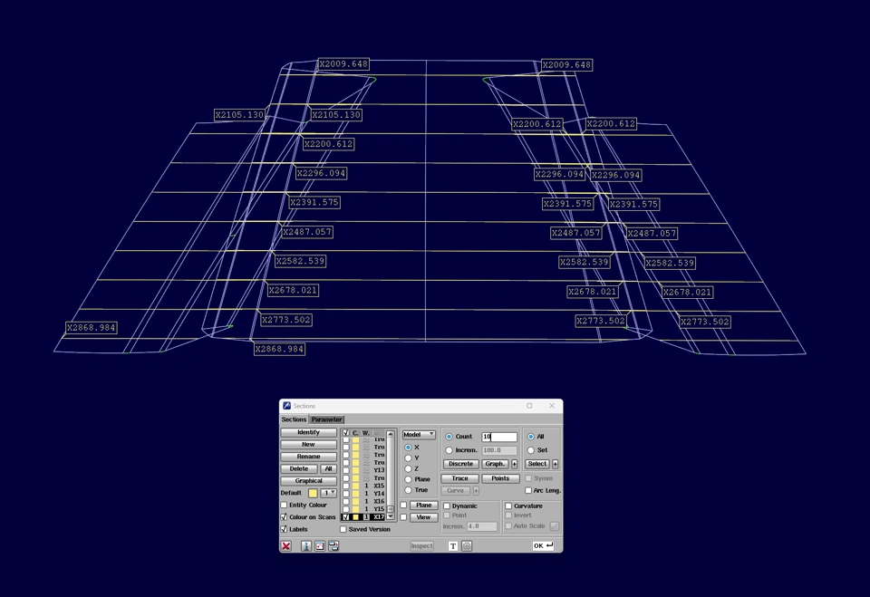

Hi, the "Labels" tick box in sections is super useful. But we noticed that for some reason it adds several identical labels to the same sections. We played around a little bit, and it seems like this behavior is purely down to the number of patches/faces.
Please see the following example, I have up to 3 Labels on the same section (data provided as well).
This might be fine in this example, but when sectioning more complex data, this get very confusing (see picture below). Is it possible to have just one Label per section?
The interesting thing is, sectioning the same data in the Reference Manager gives the result you would expect (see picture below).
