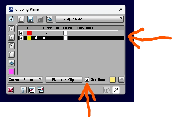

Hi, we noticed that when switching on "Sections" in the Clipping Plane menu, just shows the sections for the currently highlighted Clipping Plane. In the example below it would shoe the section just for Clipping Plane 2 (yellow).
But we would like to see sections for all active Clipping Planes. Even better would be a toggle for "Sections" within every Clipping Plane, so that the user can decide which Clipping Planes should show sections and which should not. Something like this (please excuse my very basic Photoshop skills).
Best, Julian
