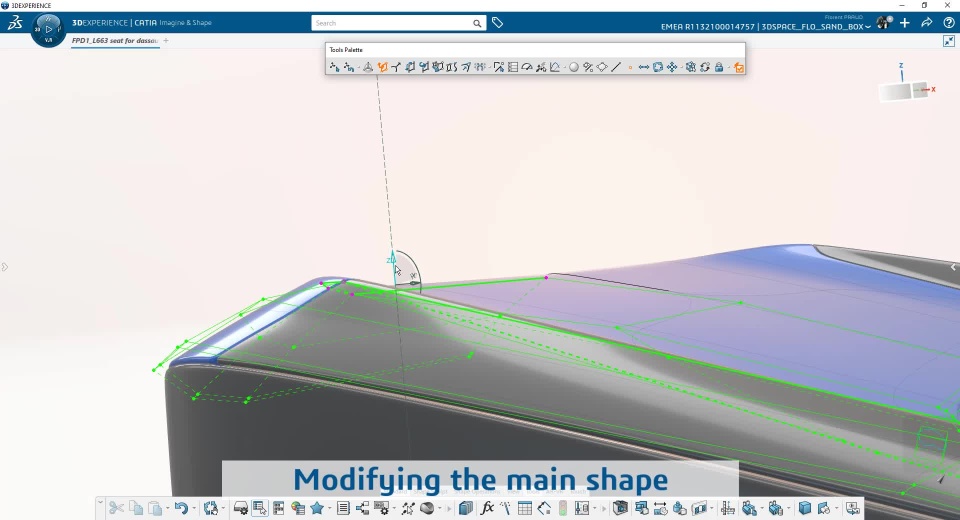

Backrest is mostly done using Imagine & Shape and subdivision modeling technology

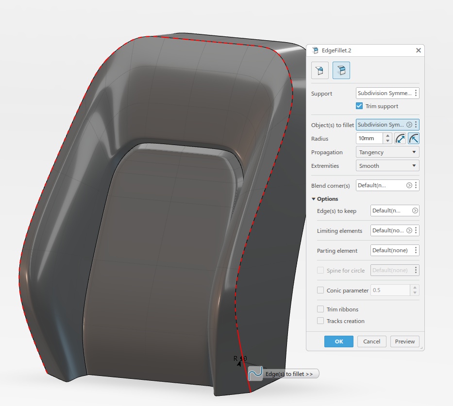

> I kept some Hard edge for controlling the radius with a parametric fillet:
I used a simple edge fillet, but fillet with control on the curvature, number of control points , segments and so on can be applied as well.

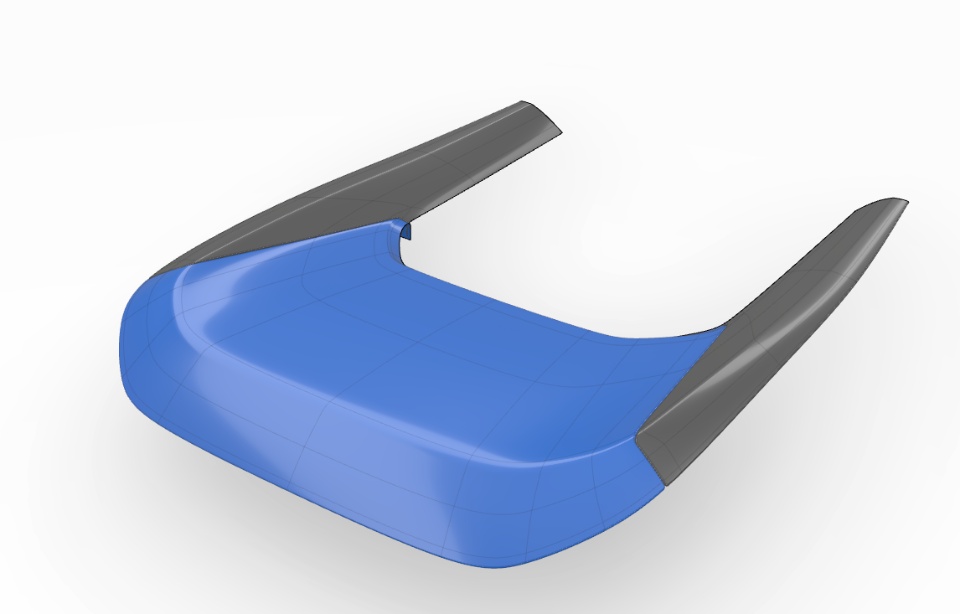

>For the lower part of the seat, I decided to divide the IMA mesh into several parts.

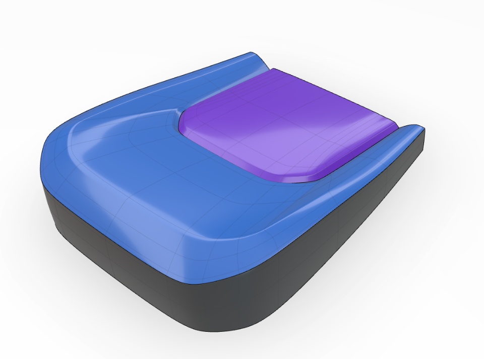

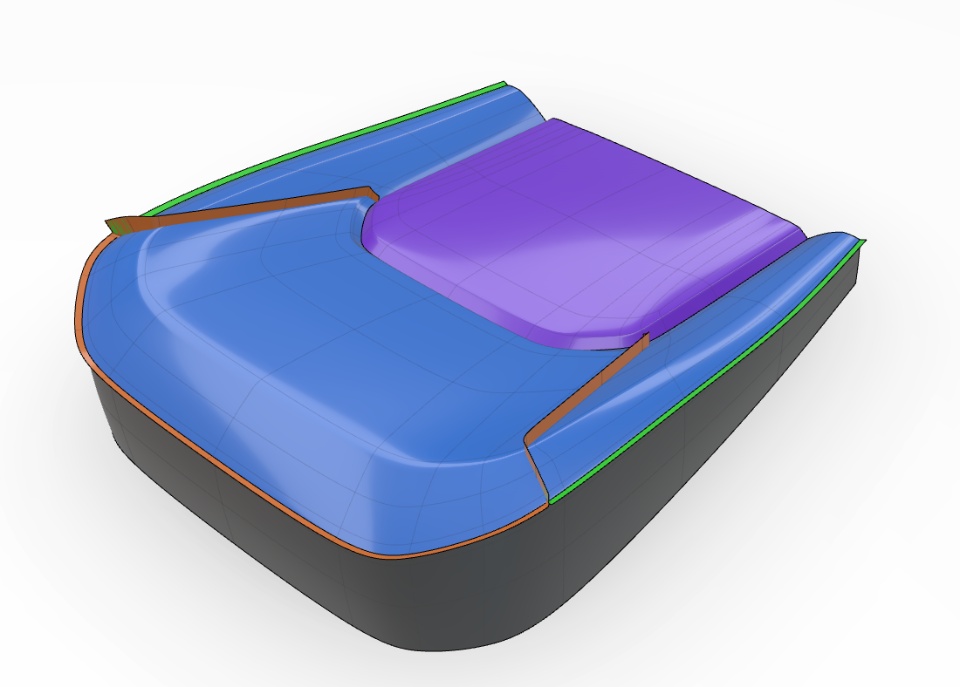

>Then, Generating the splitting surfaces
Below the result of splited surfaces with radius in the same time.

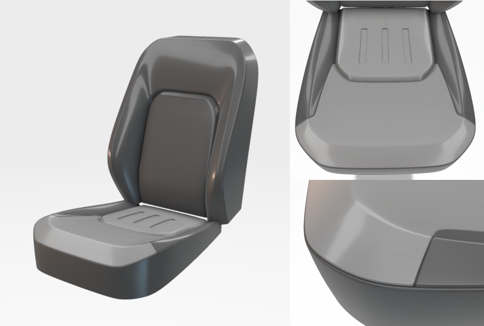

The result:
