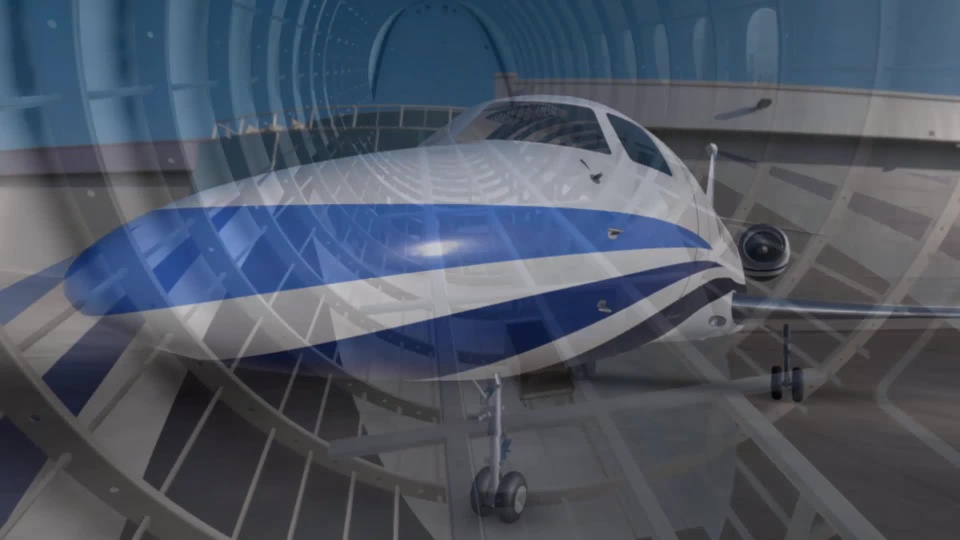

Since 3DEXPERIENCE R2017x Hotfix4 we also offer two different HMD scenarios:
1) Designer ambience: brings whatever you see in your app's viewer directly to VR.
2) Natural ambience: automatically positions your product in an optimized VR design review environment. The correct environment is determined by the size of your product. Each environment contains some known references, such as chairs, doors, etc. in order to provide a better sense of scale. Furthermore, the environments are designed to be non-intrusive but highly realistic to create a strong sense of immersion or presence.
Note: the Showroom environment in Hotfix4 is affected by a distortion bug. It will be fixed in an upcoming hotfix.
