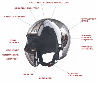

I conducted an internet search to know the manufacturing process and the helmet constitution.
The helmet is composed of different parts:
- Internal foam (Mousses internes) : Providing comfort and head handling
- Internal shell (Calotte Interne) : Made of rigid foam that allows shock absorbtion
- Outer shell (Calotte externe) : Formerly made of plastics (thermoplastics) using polycarbonate injection. With the advent of composite materials, most helmets exploit them. Either fiberglass or carbon fiber combined with resins (epoxy) to reduce weight while increasing its resistance to shocks.
