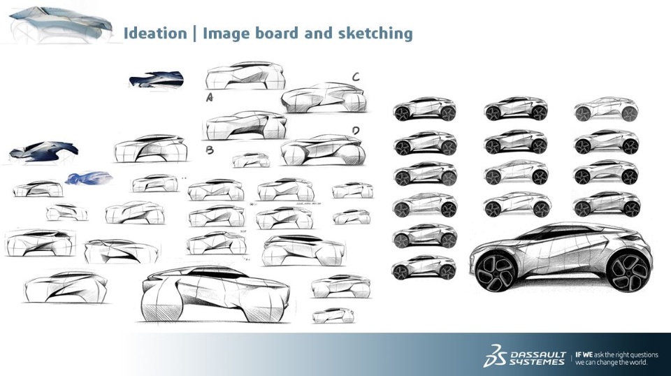

2.Ideation
In the first stage, our designer Li Yimeng did a lot of 2D sketches and 2D renderings, try to express the styling in 3D through 2D:

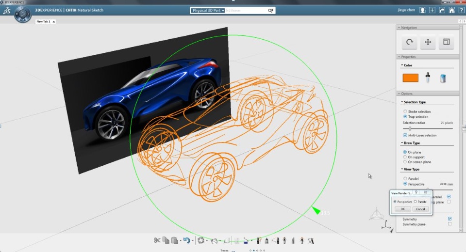

Then we switch to 3DEXPERIENCE Platform, drag & drop the side view inside, to make sure the car has right size and proportion (picture 1), then we use Natural Sketch to quick sketch the main styling curves and details of the car.
With the 3D sketching of this car, we got better understanding of the styling features in a real 3D world, and we also did few small modifications according to the performance in 3D: because you know, there is always difference between 2D and 3D.

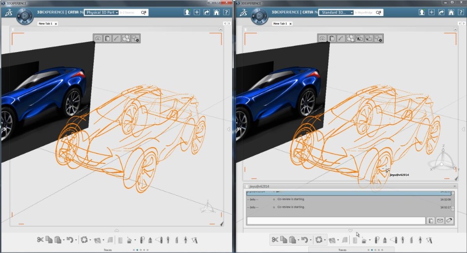

Then the step goes to be discussion.
Because our team members did not stay all together in the same office, we use 3DEXPERIENCE platform to chat and communicate and share screen to do co-review, we get better communication than ever because we cannot only follow others' words but also catch the screen and share opinions through "Mark".
Also we need do design review and modification, we input the 3DXML into PPT and we can navigate directly by using 3DXML player. Sometimes we also do review with iPad because it is even more convenient.
