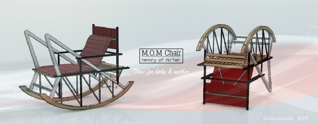

Firstly, as I recently introduced, my idea is a combination of pregnant chair and crib.
The reason I titled 'M.O.M Chair' to this is, It can be simply called as 'Mom chair', but I wanted put the more detailed concept : 'Memory of Mother'.
The main concept of my product is that inducing babies to be born and grew up at the same space where they stay with their mother from the womb.
And the goals of this concept are not only for various functions or purpose of interior, but also for the making lovely memories with product and reminisce that memories in the future.
The above image is more detail summarization of my idea.
Babies and pregnant women should be carefully protected and in this respect, pregnant chair and crib are essential furniture.
But on the characteristics of these furniture, they has short product life and cause ineffective using of living space or cost burden.
So I proposing a design solution that can solve these problems by combining pregnant chair and crib.

I turned the initial design into more detail design through the CATIA Natural Sketch app.
If initial idea sketch only applicated concept and design motive, my 3D sketching process focused on commercialization and more structural design with view from various angles.
Firstly, I adjust structures which is can be regarded impractical in the aspect of human body such as shakable angles.
And I divided produce structure by quality of materials for the low price output and more effective endurance for the weight. Because in the initial idea, the price of product
exceeded sum of two furniture`s price. But I did not ignore the stability while I adjust the initial idea. Because safety must be first priority all the time.
And then I put the thickness into line sketch with various colors by quality of materials.
In this step, I regulated actual size ratio of chair and human body by adjust scale and angle of lines.
And I moved this adjusted design into CATIA Imagine & Shape program for the big structure modeling.
The initial modeling was a materialization of 3D sketch for the visualization of high ratio design.
The real time rendering visualization allows a full understanding of the output, including colors and ground effects,
without the addition of a specific rendering program.
