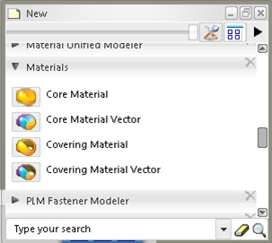

PLM Access
- New…
- Covering material
 2

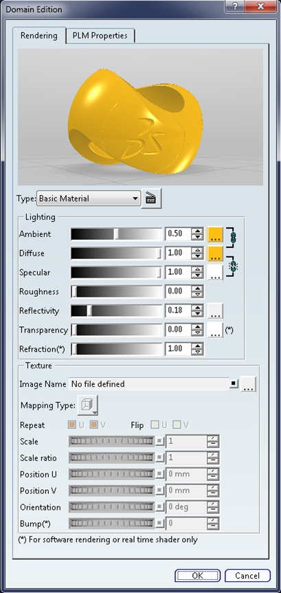

A new material is created on the tree : Right click on it
- Add domain
- Select « rendering domain » > ok
- Double click on « MatDomain-xxxxx »
  3
  Material edition
Change the ambient & diffuse color
Click to load a texture
Map the texture : Modify the scale / position/ orientation

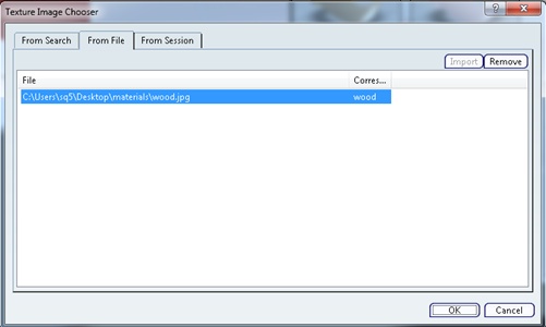

To load a texture
- Import your texture (For instance, a wood textur)

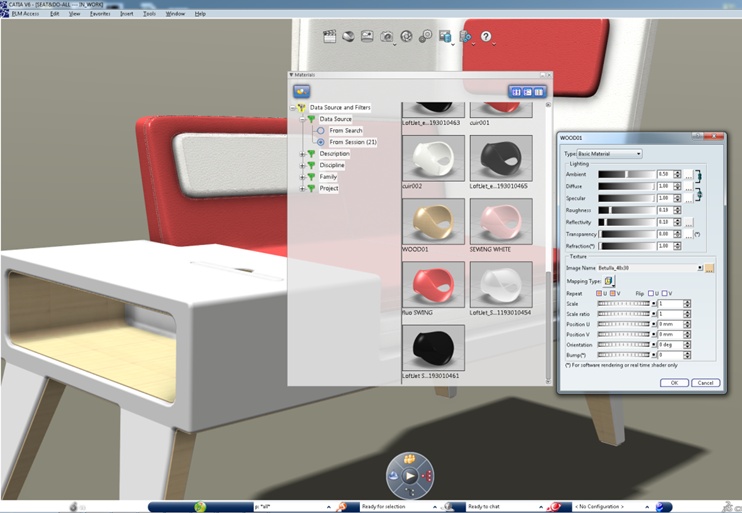

  5
Apply your new material on the specific object and map it correctly

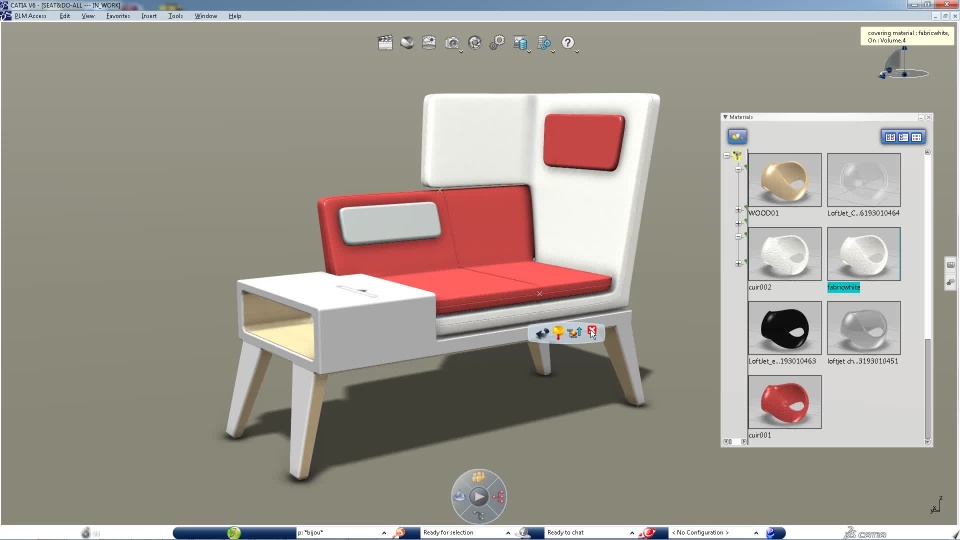

2- HDR
Here are some live rendering examples. Find in attachment the HDR we used, you can download and use it for your creations !
HDR file
 How it looks like
