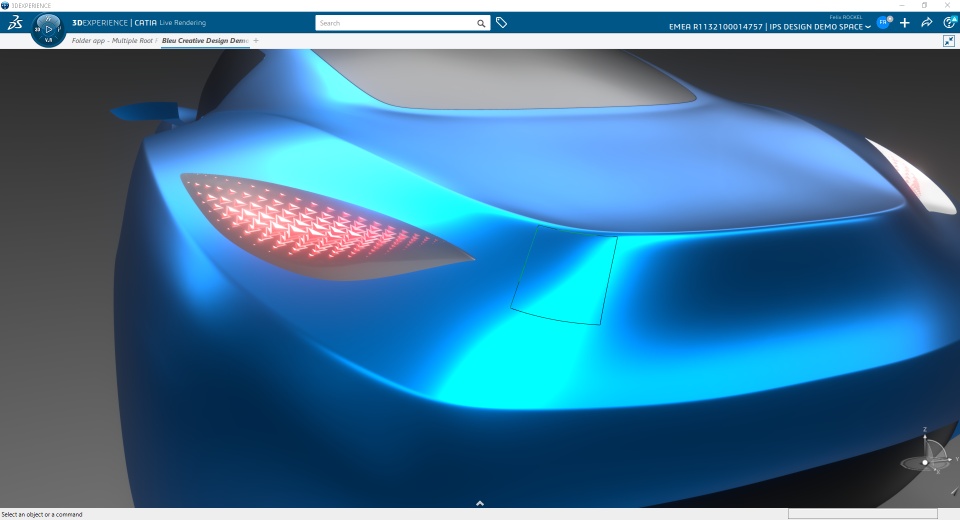

1. Step is to generate the base shape of your Design concept quickly in Imagine&Shape. This step is done in the native Client of the Platform (Image1).

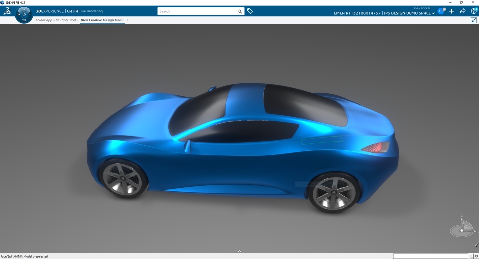

2. Step is to open your light surface in XGenerative Design in the Browser. Now you can start to generate your parametric pattern (Image 2).

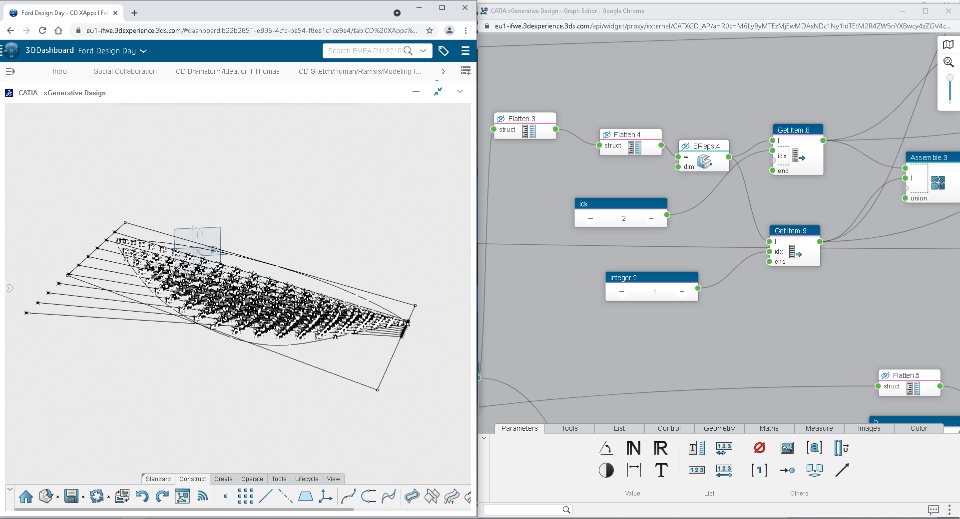

3. After publishing your data in XGenerative Design in the Browser you will see it instantly (after Global Refresh of your Scene) in your Native Client. Here you can still access most of the parameters in order to adjust the pattern to your needs in context with your overall design shape. In the last step you can assign materials in CATIA Live Rendering to your pattern - in this example a emissive red light, in order to experience your pattern in its full beauty (Image 3).

Image 1 - Quick Concept model with Image&Shape
Image 2 - XGenerative Design parametric pattern creation in the internet browser part of the 3DExperience Platform.
Image 3 - Pattern Published back to Native Client Part of the 3DExperience Platform and Visualized with CATIA Live Rendering.
