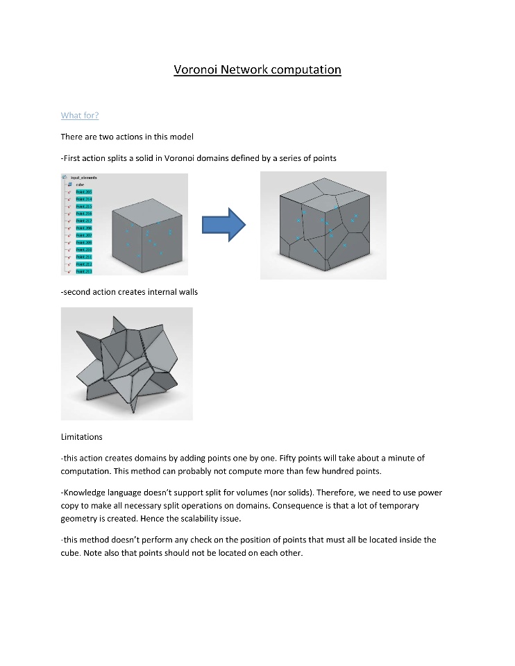

A Voronoi in 3D
A trend in architecture: use 3D Voronoi network in building design.
More about Voronoi network...

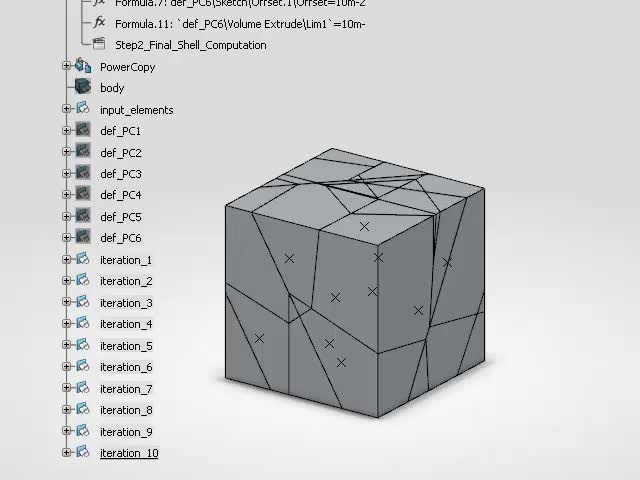

This script of knowledgeware can automate the design starting from a cloud of points
instructions and video
