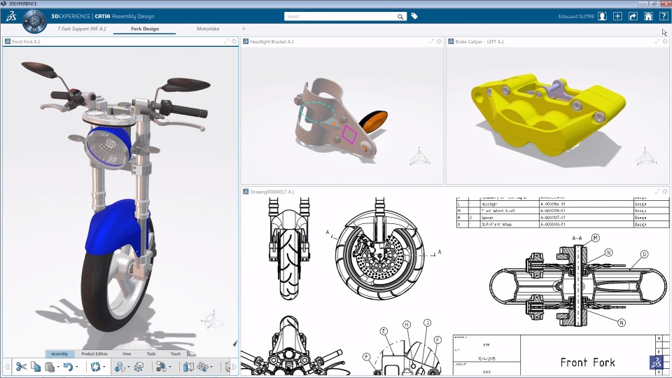

This first video shows how to split the working space in 3 areas to display several contents of a same design project:

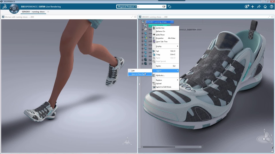

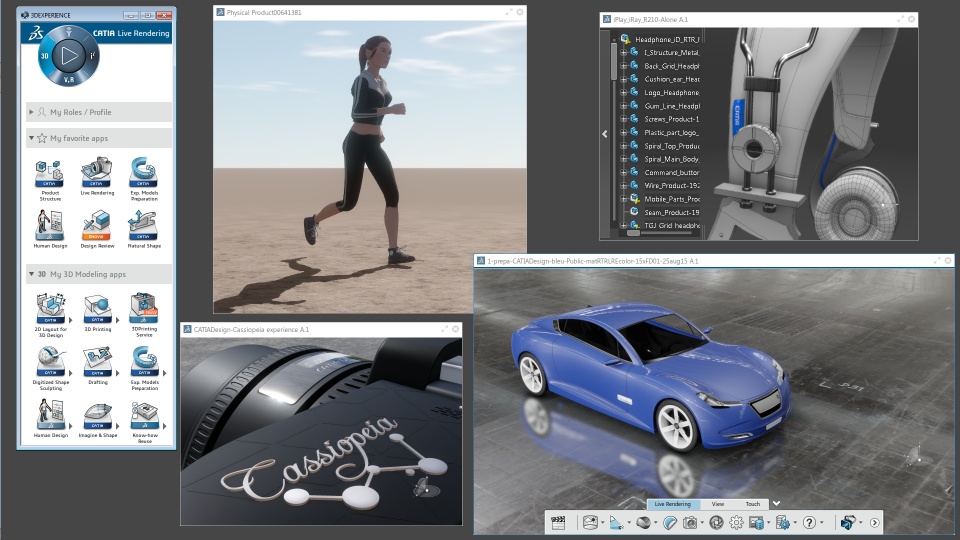

Each of these areas (widgets) can be dragged outside the 3DEXPERIENCE frame. Convenient to take advantage of a second screen, or to review several projects, like show on this screenshot:
This Youtube video shows all the possibilities in action:

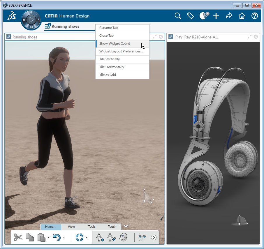

  1. Activate the Show Widget Count option (right-click on a tab name to display its context menu)

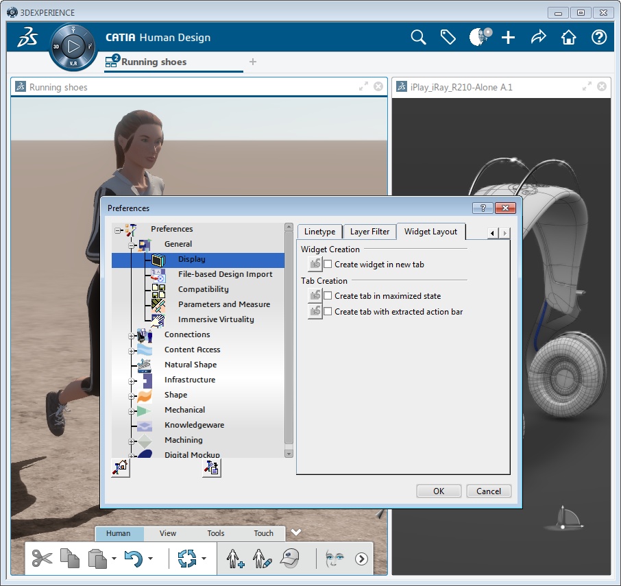

2. Turn off all 3 Widget Layout Preferences options:
