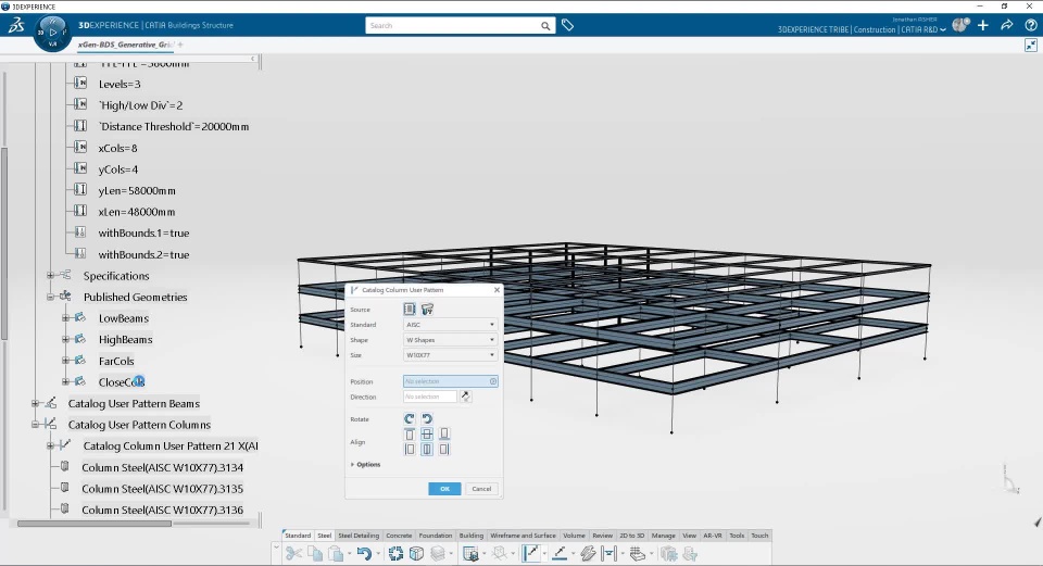

Hi All, in FD06 Beam Patterns in Buildings Structure have been improved to update dynamically, adding or subtracting members on the fly. This makes connecting Building Space Planning to xGenerative Design a very powerful option for creating generative structural models.
Check out the video below that shows how to use the new beam pattern feature with a xGenerative Design wireframe model. Follow the link to watch on YouTube for more related content:
