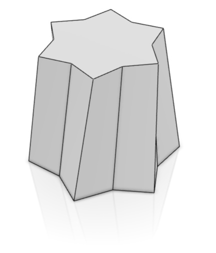

I prepared a simple model. This model remembers the order in which the designer modeled it. It includes the process of positioning the shape, drawing the bottom plane, drawing the height of the top, and changing the cross-section.

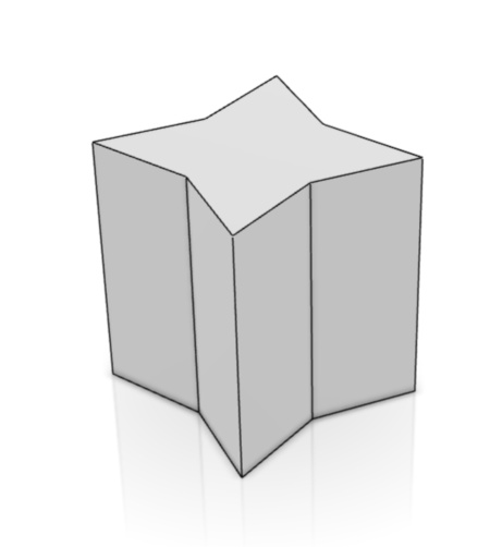

Also, if there are variables that you want to change frequently at each stage, you can easily access these parameters by exposing them at the top of the tree. Here, it is included in the design algorithm that changes the number of sections by modifying the integer. I also set the size and twist of the shape of the upper part.

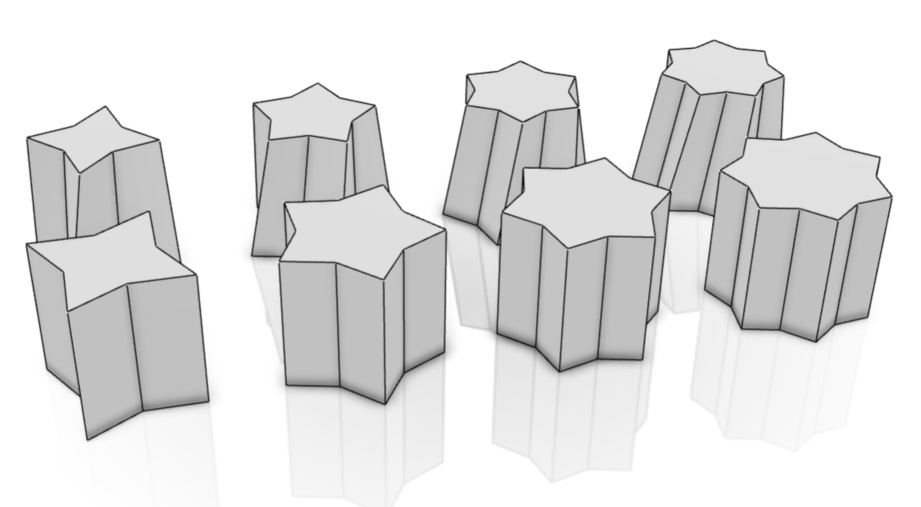

By copying the design know-how model created in this way and changing only the location and parameters, various design results can be created quickly and easily.
(image3)
We call the design know-how model a template. The process of producing templates repeatedly is called automation.

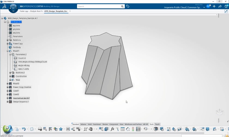

After the mass design process, the exterior pattern design process is applied as an example of the next step. Likewise, it is possible to modify the change item of the external pattern and it is connected to the upstream process, so if a change occurs in the upstream process, it is reflected in the downstream process.
