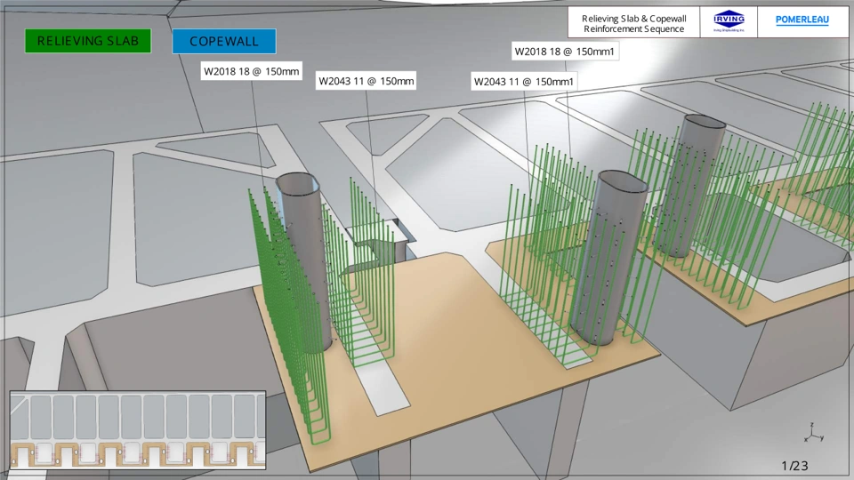

I just finished a huge rebar model for a marine project. I modeled rebars from shop drawings. In ten days i was able to provide all bars and make a sequence using 3d markup.
