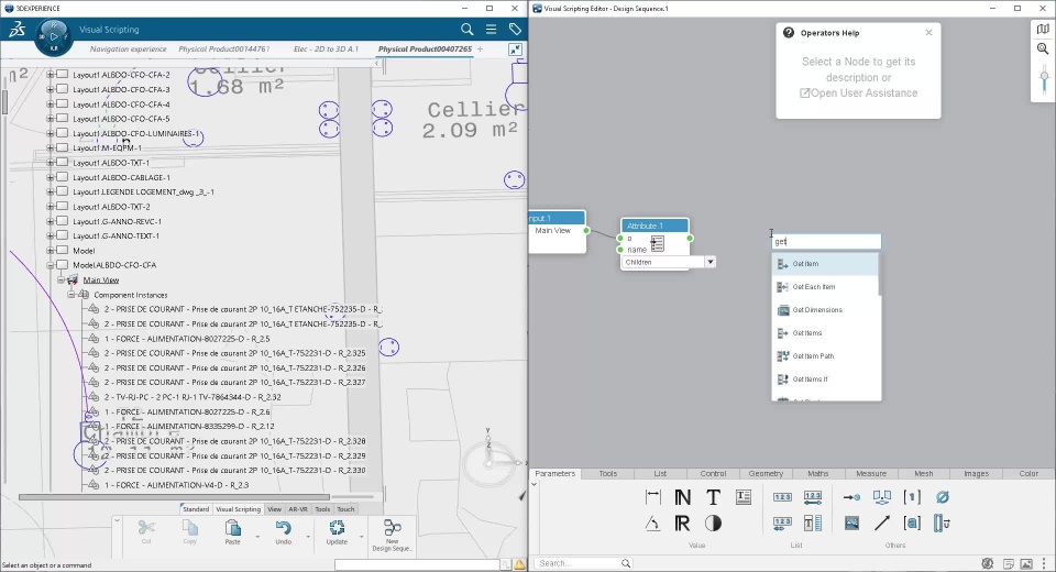

Xgen is able to scan a 2DLayout View and see all the Dittos inside with their properties ( position, orientation and name).
Thanks to that we can easily extract all this information and create an Axis System correctly oriented for each Electrical Equipment .
Regarding the Elevation of the Equipment, since it has to meet standards, based on the Name of the Equipment you know which type of equipment it is and then you know at which elevation it has to be.
Here is a video which illustrates how to extract the dwg information from Xgen

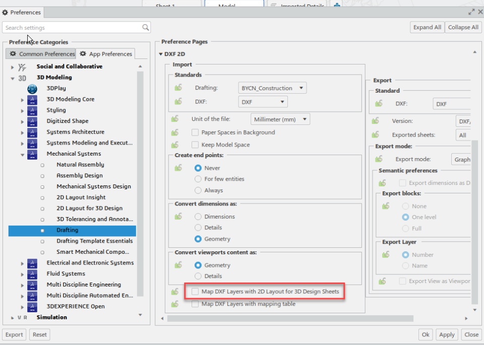

Note: In order to minimize the number of Sheets when you import a dwg file inside 2DLayout you can unselect the following option:
