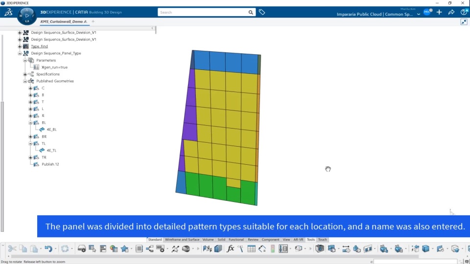

This Example shows some of Automation for Design Data Management
Automation for "Slice with Analysis information"
We want to Analyze if the surface is a triangle, Square, or pentagon
and also, want to find out if the length of edge has enough length for the manufacturing details
Template & Automation for "Type Classification"
Details might differ depending on location. even same design intend.
for example, The details of the typical and corner parts will be different.
Template & Automation for "Information for BOM"
Before Build Detail Template or Engineering Work, We may need a schematic bill of materials for estimating.
Hope you understand how you can do this design data management in CATIA through this example.
